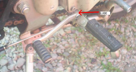

4 clutch cable adjustment ---too little free play can cause shifting problems
also the shifter and its linkage may need some spray lube ...
mine was shifting poorly and when i got the free play a little bit more and lubed the link and shifter
things work much better edit took foot peg off and used never seize on the lever pivot 6/12/09---

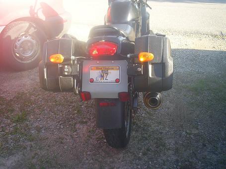

6 replaced turn signals on rear with set from KTM DUKE about 2001/02 model
the ori had been replaced with a polished non dot set .they were having problems and one was broke--
the fellow inspecting the bike in June said make them go away before next inspection
the ones from the DUKE look better ....more like "i belong on this bike"
all for now dave sat June 27/09 edit add items 5 & 6 plus pictures 6/13/09
search word Travellernotes
what a well pampered traveller should look like--with a proper set of turn lamps
these lamps from ktm duke 2001?
remove and lube with a good water proof grease

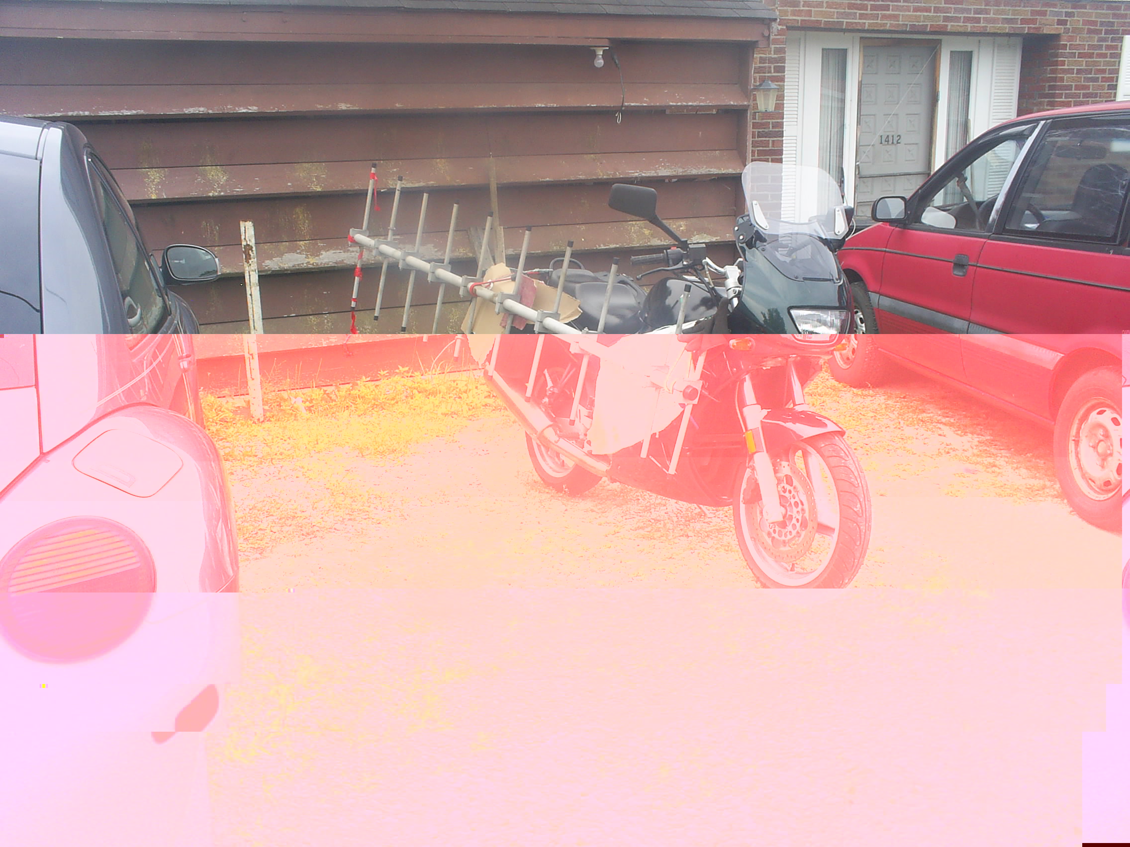

just to add picture of home made add on wind screen
and show how to turn a traveller into an LT model
AS IN LIGHT TRUCK
out for a ride .. stopped at a ham radio friends house he had a free antenna on the shed roof...
but it was too far to go back with the truck
turns out the thing is for usa channel 12 TV 204 to 210 mhz and i need one for the station at clarksburg wv wboy-tv
and it may work on the one at Huntington wv on channel 13 210 to 216 mhz
it was a piece of work 110 inches long and made in the 1960's by blonder-tongue
