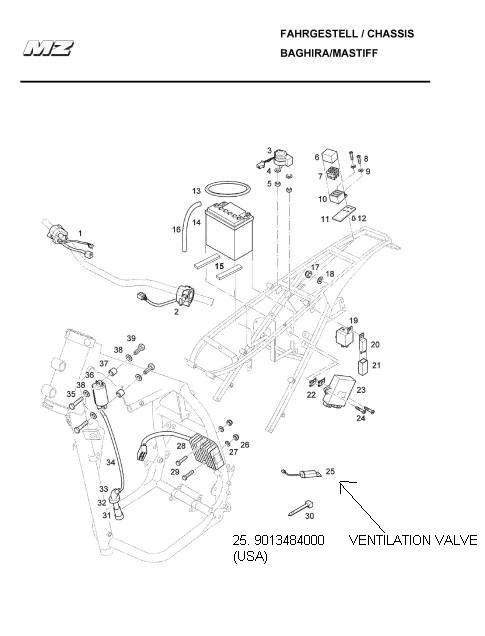

Postby edec » Fri Jun 19, 2009 7:26 pm
Location: right side as seated, below headers, above and behind rear brake pedal and clutch cable attachment, just in front of swing arm pivot/frame.
Appearance: size/shape of a "D" battery, attached to bracket by a thick zip tie, electrical wires connected to side; hose from left side carb (other hose T'd from another hose that disappears between both carbs)going into mystery part, and finally a vent/drain hose exiting the rear/left side of said part to beneath bike.
Could someone please tell me what this is, what it does, and can I live without it. The hose leading into it melted against the exhaust pipes and split in two.

Re: Need help identifying part on 2001 Baghira
Postby DAVID THOMPSON » Tue Jun 23, 2009 5:36 pm
try this picture
click on picture to expand it to full size
9013484000 Abschaltventil (english = shut off valve) 12V 7.2238650. £62.39 £71.75
electrical devices.JPG (31.17 KiB) Viewed 3858 times
Postby edec » Wed Jun 24, 2009 9:45 am
David I think you're right! I looked at Grahams' website and looked through every diagram and came to the same conclusion. Now, does anyone know why this "Ventilation Valve" is used only on the "USA" bikes; what it's function is; do I need it, and if I don't, what to do with the wires.
Much Thanks- Ed
01 Baghira
99 Ducati SS750
edec
Posts: 146
Location: California, USA
