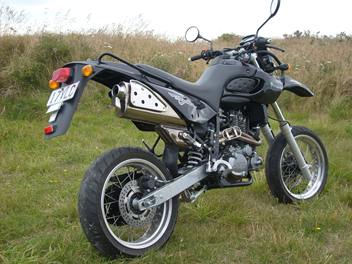

Just thought i'd tell you about the tyres i've just had on my Baghira... I dont go off road and with all the piggin rain we are getting in the UK... I was getting a bit fed up with the back end twitching!! so bit the bullet and treated me to a pair of Dunlop Sportsmax.. absolutely brilliant!! cant get over the difference.. it just rolls into corners and so smooth.. Nice to feel confident 8)
See a couple of updated pics..... http://www.bikepics.com/members/elcaptain69/
So carb.... had loads of probs on tickover... the can was on the bike when i got it... never really ran perfect.. had carbs off a few times to check and clean... but found nothing serious... messed around with mixture... in the end.. as one or two have said on here... 5 turns out... (which I thought was far to much!) sorted it!! runs like a dream... still a bit choked at "wide open throttle" but I think notching the needle up on secondary carb will probably sort that...Just got to get around to it! it ain't that bad.
