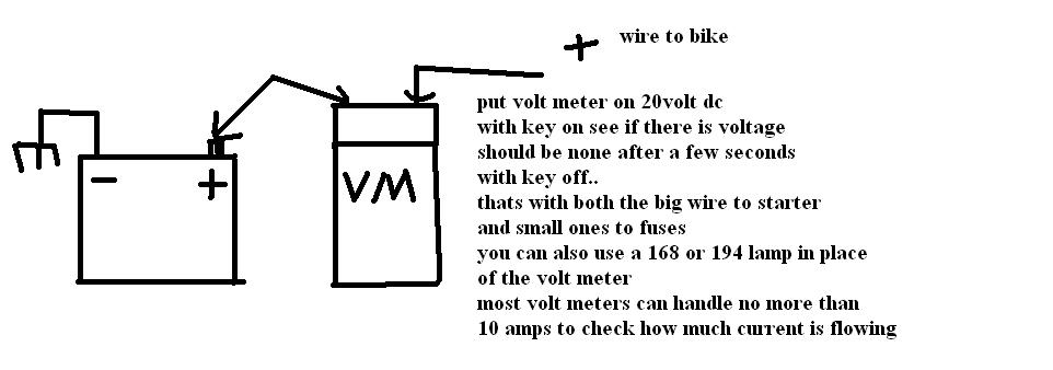

Postby DAVID THOMPSON » Mon May 04, 2009 3:25 pm
see attached picture
this will tell if things are turned off or stuck on
meter in 20 volt for most bike and car testing
click on picture to expand it for full view
test for flow with key off
test for flow.JPG (41.05 KiB) Viewed 2209 times

Thank you DT. Thats very helpful.
