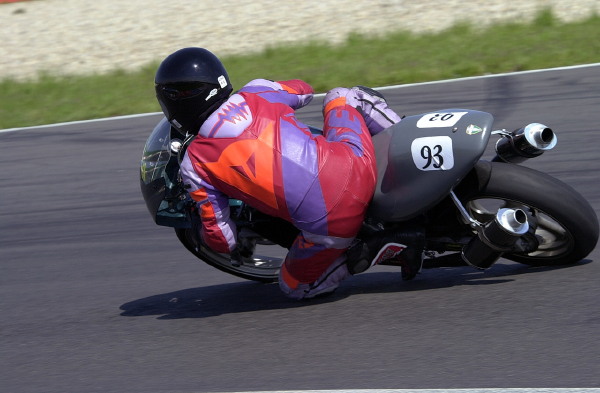

Training for SOT event , Lausitzring
I think you can see that the can will ground before the peg does, and that I have already had to tuck my knee in out off the way.

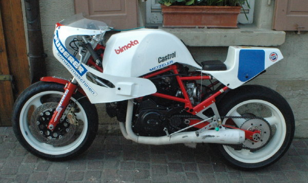

I did loose the nylon end plug of the Bimota peg once on the Pannonia ring, holding 996s and F4s at bay.
I made them quite long and probably forced it off with my foot.

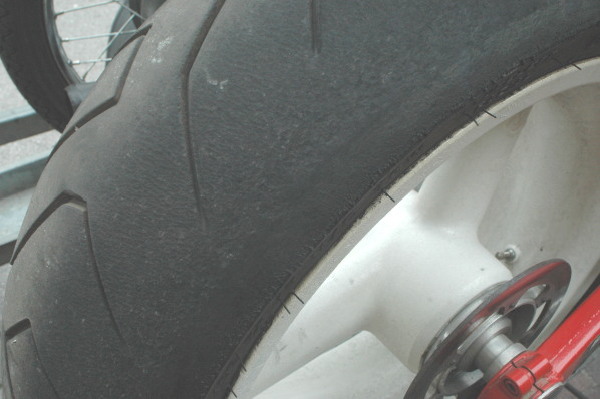

you can see that the 180/55 Super Corsa is used right out to the very edge.
get a load of that diminutive rotor at the back.
