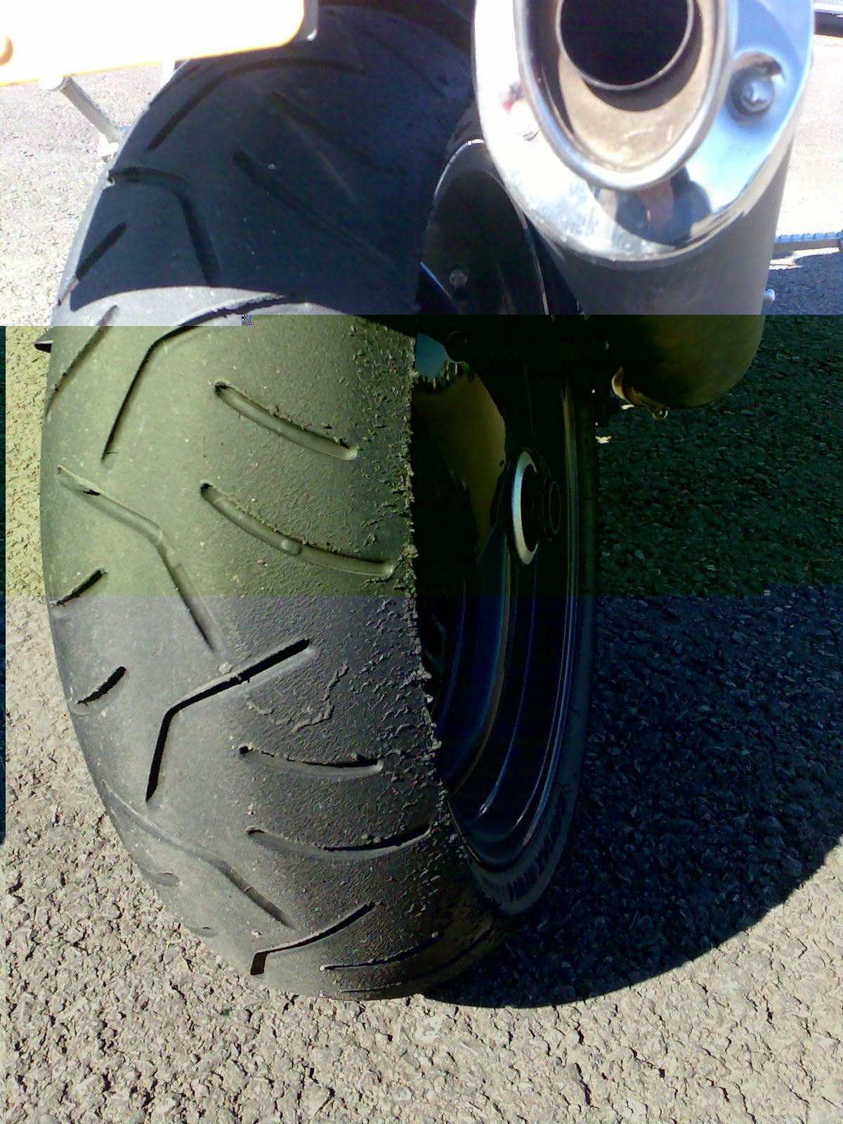

As can be seen from tyre below bit too much motorway use (flat bit).

Yes, noticed the photo was not a Skorpion. In street use, nobody gets tires like that with a Skorpion, Besides, the one-arm swing arm is a give away.

thought you'd notice, thats ma 1999 speed triple - with 955i engine - on stupid day out. Dont do that any more too old!!!! Hence the skorpion for lazy sunday ride outs thro the back roads to Llandovery. To many speed camera now!!!
