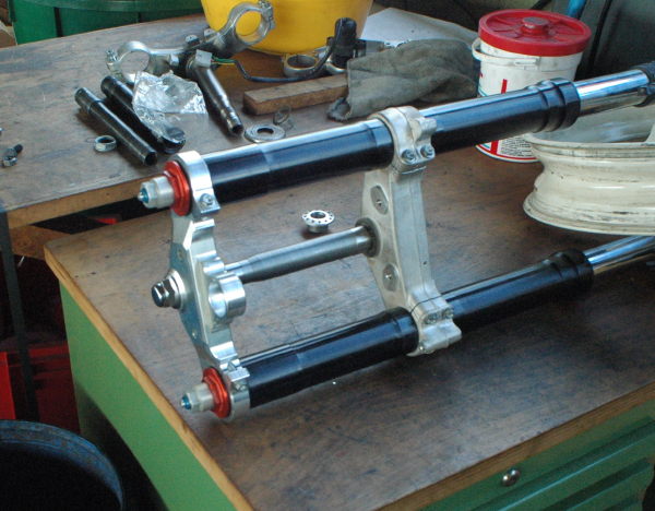

OTOH hand, tho there is no such thing on the Skorpion, using the OEM specified torque for upside down fork triple trees is of the utmost importance. These torques are very low and nowhere near what the thread size would dictate. If the lower clamp is tightened more, the tube is pinched and can easily bind the staunchion. That is also the reason why such forks cannot be moved up and down in the clamps or only to the extent the clamping surfaces allow. It is also the reason for those extra wide CNC-milled lower clamps with 3 and 4 bolts on some USD forks;
Not just to look sexy but to offer more frictional clamping surface at low torque. These re my own one-offs for my racer.
here is the stock USD fork of an Aprilia Mille which I fit into a Yamaha SZR by making a new steering post and shrinking it into the lower clamp:
You can see how wide even these the lower clamps are and also the raised, turned surfaces for clamping.
Just an example. The RSU fork of the Skorpion is completely carefree in this respect. RSU forks do not need anything special.
