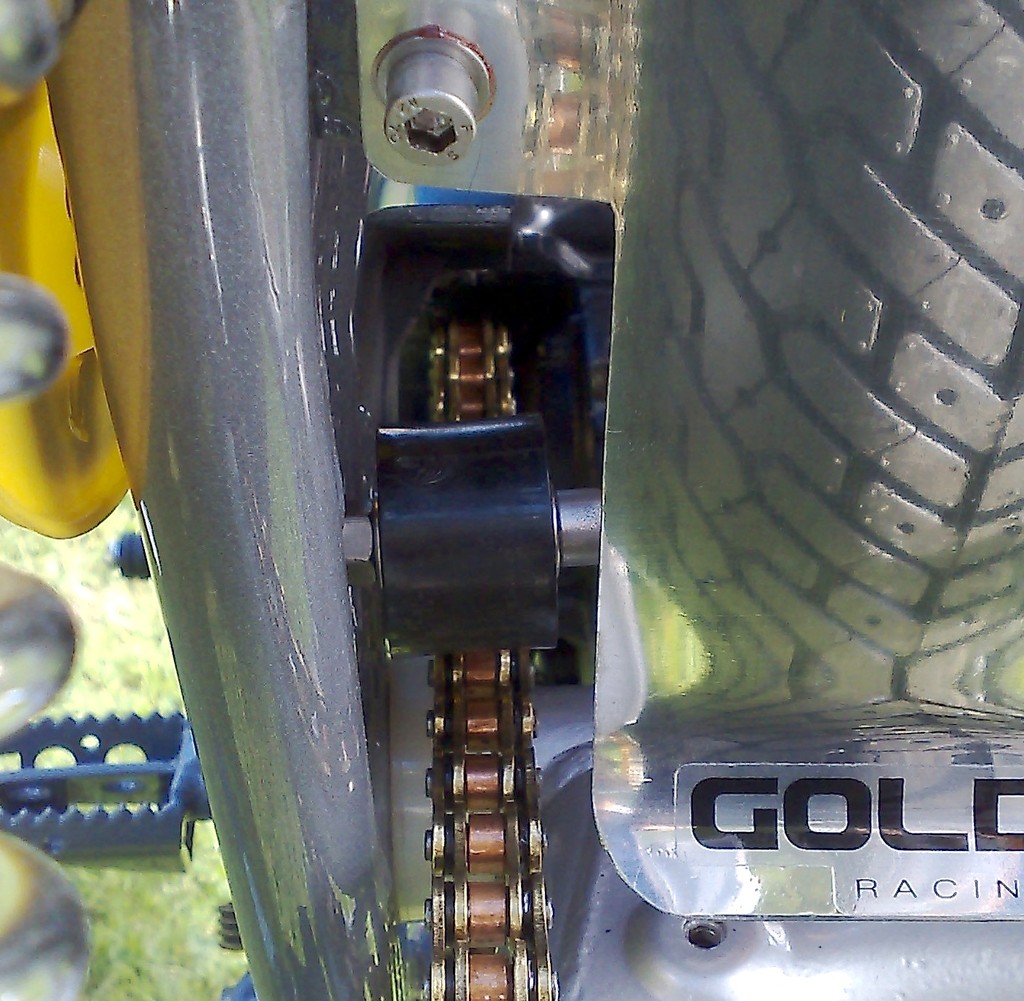

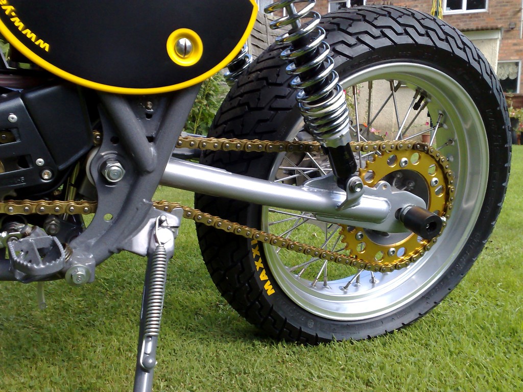

Postby handsomejackuk » Mon Nov 10, 2008 5:51 pm
15/45 sounds good to me as i had heard that anything less than 15 on the front is not kind to the chain. don't know why.
my chain is clicking a bit and has a few tight spots, so looks like a good deal to me.
what is the quality of chain and sprockets fbor £8 isit any good ?
i do like this chain...

Postby hutchy » Tue Nov 11, 2008 2:10 pm
the quality of the chain seems fine, no adjustment needed for a long time so i guess it must be ok, you should see a marked improvement as far as power delivery goes from standard, mine now feels like it should of done when it left the factory. it doesn't seem to have affected the top speed too much but there again i'm not into riding at three figure speeds in this over policed nanny state
