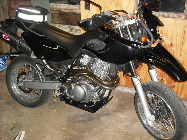

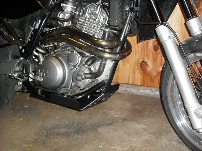

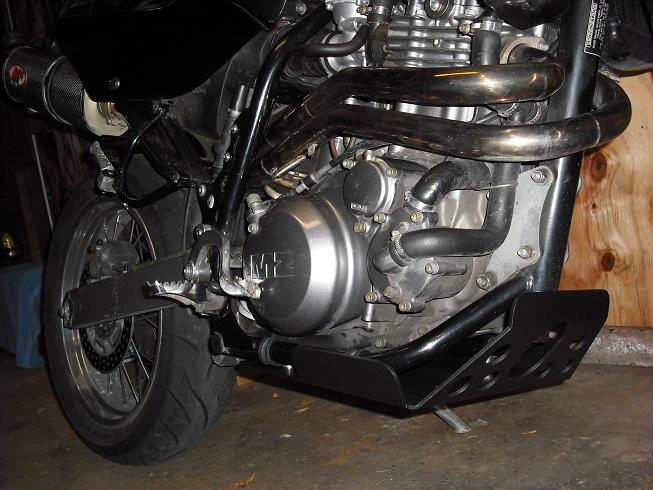

Postby pamonster » Thu Nov 13, 2008 11:28 am
incase anyone wanted a look. i guess what i used to cover it with was spray on truck bed liner (duplicolor truck bed coating) that I got at Orielly's for like 6 bucks. i like how it turned out
