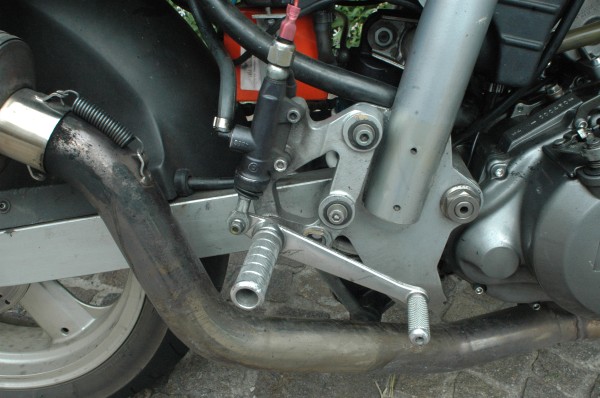

Postby Bill Jurgenson » Sun Oct 26, 2008 3:42 am
You seem to be talking about brakes levers. There are none that fit into the Grimeca hand pump without machining.
Not billet, cast, but more than good enuf: the foot brake lever from a Yamaha TZR/SZR fits onto footpeg.
replica peg-right side.jpg (71.54 KiB) Viewed 4070 times
This is such a Yamaha lever on an original MuZ Skorpion Replica peg fixed to a standard Skorpion Tour bracket.
Probably most any Yamaha lever will if the bolt hole for the plunger is at the right place. In fact probably most any brake lever, regardless of marque, will fit the peg. The only question is where the bolt hole is.
