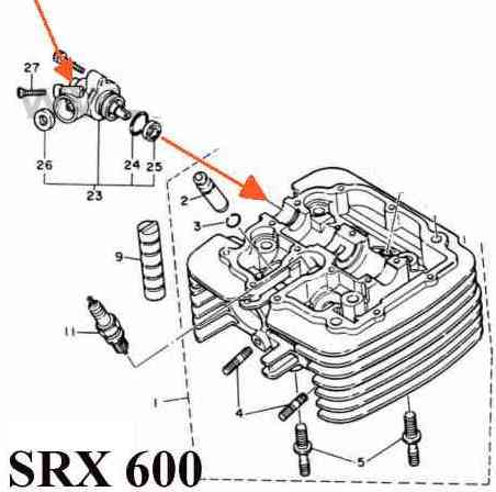

Now there's a blanking plug with an 'O' ring fitted to the right hand side of the Skorp's cylinder head, in the middle, that reveals the end of the hollow camshaft. This has a cross-pin that fits into the little drive gearbox (arrowed in the drawing below) which transfers the drive through 90 degrees and into the cable (otherwise you'd have a foot or so of bendy tacho cable waving in the breeze, see?).
The question is, does anybody know what other engines use this tacho gearbox, please? The dealer wants £70+ VAT + carriage for a new one ............ that's more than I paid for the replacement tacho AND the cable............ :shock:
I've bunged the drawing up so you can see what I'm burbling about.

XT550, TT600, XT600/Z/E/K, XTZ660 srx use this bevel drive. The price of £70 is less than the standard one to be expected when new.
You can get it from KEDO:
you can change the language to English
Assuming the frame doesn't expire:
that's on page 79 of their catalogue:
27296 Getriebe-Einheit Drehzahlmesseranschluss
Manufacturer: Yamaha
XT600 Drehzahlmesser-Antrieb
Zum Nachrüsten von XT600 und TT600 geeignet
Einfacher Selbsteinbau, Motor muss nicht geöffnet werden
Original YAMAHA Ersatzteil, Lieferung inklusive O-Ring sowie Simmerring komplett (Instrument und Drehzahlmesserwelle bitte separat bestellen), Farbe silber
Order this item:
Status Price Add Quantity
Special order, no stock 105.00 €
Price includes VAT and excludes shipping cost
105€ = £82,70 plus shipping
otherwise, you'll just have to watch eBay until something comes up.
