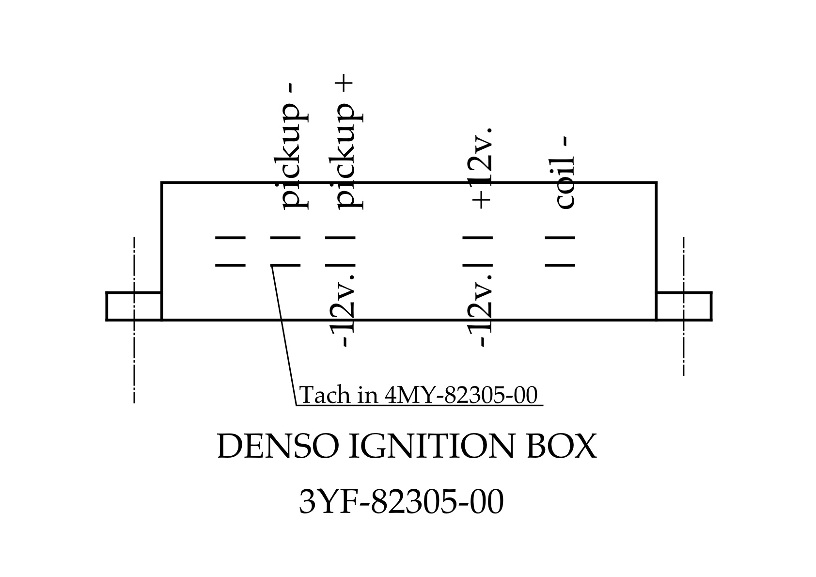

here is are the pins named for what they are:
Denso box.jpg (120.36 KiB) Viewed 2183 times
no colors, just what the wires actually are.
This is the same for all three possible boxes.
For the Skorpion, the harness is like this:
from the bottom up, which is how you requested:
C- blue/yellow
D- gree/white
G- brown
a- red/white
F- black/yellow- coil and green/red tach
B- brown
The Baggi is the same except for F, the wire going to the minus pin of the coil.
Like later Skorpions, and the SZR, the Baggi may have a separate pin on the box for the tach, noted at the top.
