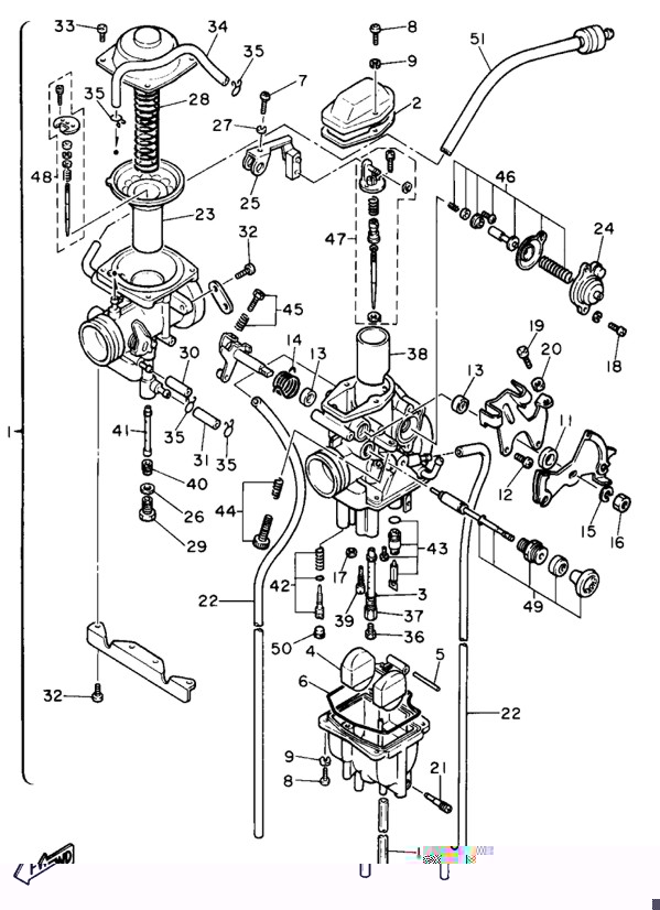

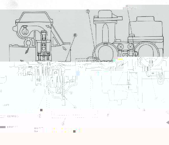

Postby cat » Fri Sep 05, 2008 4:19 am
:smt006 So, did the main jets fit properly? :?:
On the site it says that their "Teikei Large Main Jet" fits the 87-89 XT600. I know that there are some years of XT600 that used the identical carb as the Baggy, but I'm thinking that it's more like the mid-90s XTs.
XTZ Tenere 660.
google XTZ 660 vergasser
I've got the exploded diagrams and some translated explanantions and stuff I collected, send email to bparker [at] mrpricegroup.com if you want me to send them to you.
PS: XT600 1995, same carbs.
Attaching some stuff now.
Yamaha XT600 1995 carb parts diagram.zip
(375.85 KiB) Downloaded 126 times
Yamaha XTZ660 (1991) carb schematic (SAME as MZ Skorpion).gif (153.02 KiB) Viewed 3282 times

Re: A U.S. Jet Source?
Postby cat » Fri Sep 05, 2008 4:31 am
More files attached.
