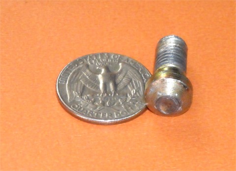

Postby frederickflintstone » Wed Jul 23, 2008 9:57 pm
HELP! what is this, and where did it come from? it fell off the front of my 02 baghira and I can figure out where it came from. I ran out of daylight to do a thorough look, and can look more tomorrow, but I thought someone might know.

Postby Bill Jurgenson » Wed Jul 23, 2008 11:04 pm
whatever it is, the nut is missing as well. Since it has no gripable head, the threadless shaft probably cinches tight into its hole.
What size is it? M8?
laying it next to a quarter doesn't say s--- to the rest of the world.

Postby frederickflintstone » Thu Jul 24, 2008 12:07 am
I think it is an m8 but I didnt measure it, sorry. It used to be that everyone loved US money, my guess is a quarter is about 30mm in dia. 35 years of being exposed to the metric system and we americans still thumb our noses at it. personaly I think traveling at 300 kilometers per hour sounds better than 186 mph!

Postby handsomejackuk » Thu Jul 24, 2008 4:13 am
this is a bolt from the ignition key. It is designed to break off when put on and leave a head that cannot be removed. Check your ignition switch under your yoke, and you will find that on or more of the bolts are gone. Also have you noticed that the steering lock is more dificult to put on this is the cause. Get a replacment alen key type, then you can remove it yourself. Problem is anyone else can to and steal your bike
hope this helps.
Jak

Re: HELP! what is this part, and where did it fall off from?
Postby Nils D » Thu Jul 24, 2008 1:44 pm
On the Skorpion, the bolt to the ignition-lock has a head formed as a "normal" screw, but it can only be tightend, if you try to untighten it the screwdriver will slip.
The lock for the saddle uses two bolts with break-heads, but they are smaller, M5 or M6.

Postby aah5 » Thu Jul 24, 2008 9:40 pm
Sure looks like the bolt from the ignition switch assy. yours came out easily,(fell out) had to take top yoke off and drill mine out when I replaced my switch.New switch assy comes with bolts that the heads shear when torqued up.relaced mine with standard socket head, awful hard to get up there with tool to remove switch when all together.

Postby frederickflintstone » Thu Jul 24, 2008 10:23 pm
thanks for the imput guys, I didnt get a chance to look tonight. I think I will cut a slot in the head and use a straight screwdriver to put it back. I will put a dab of locktight on it for goood measure. thanks again.

Postby Bill Jurgenson » Fri Jul 25, 2008 12:09 am
from the looks and size, you're probably right.
Strange, tho, that it should fall off of its own. On the Skorpion, it is glued in with Locktite and together with the head described above, it is impossible to remove. The ones in the Skorpion are also hardened. I have alwas had to resort to milling the heads off once the triple-tree was removed and then turning the stubs out with a pliers.

Postby handsomejackuk » Fri Jul 25, 2008 4:00 am
yay, seems like i was right. :lol:
next question please......... :smt041 :smt041 :smt041

Postby Nils D » Mon Jul 28, 2008 5:04 am
Picture of the two lock-bolts on the Skorpion, a break-bolt for the saddle-lock and the hardened bolt for the ignition lock:
Skorpion Traveller 96
Postby iceman » Tue Jul 29, 2008 1:04 am
I had mine back out on my falco and i noticed how loose the ignition was when getting fuel and it,s only held in with the one or at least mine was and i hate to think of what could have happened had the ignition fell down into the front forks at speed.
