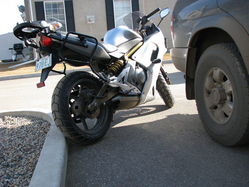

Hey guys thanks for the info. This will deffinitly help me out. It looks like my only real choice (with out getting a new front rim) is the Avon Distancia. I believe their 150/70/17 and 120/70/17 will work. I'm sure you all think I'm crazy for wanting this type of tire on a Tour but it makes sense for the riding conditions I'm in, lots of gravel roads, 1 mile of dirt road from pavement to my house etc. I won't be hitting the motocoss track or wild singltrack I promise you. The Tour lends itself well to this type of riding, just needs a new pair of boots! Thanks guys.
Check this guy who put em on his Ninja, working well for him in a similar riding situation. Saskatchewan!
