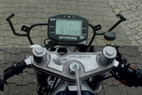

or you can go whole hog for something really high tech (and again servicable!) like an instrument from AIM.
This Mychron 4 2T is the low-level entrance model costing around 450€ once you have all the bells as whistles that you need.
-Analoge and digital tach - the RPM range can set as desired
-shift flasher - can be set as desired
-two temperature sensors defined as necessary, each with a freely definable warning light
-voltage
-laptimer
-USB readout of ALL the data
etc etc etc
You see it here mounted on a racing Skorpion I built up for a friend. I can highly recommend it. After his first serious outing the friend is full of praise as well.
The [Mychron 3 ca do much more including speedo but also costs much more.
Like I said, this is getting real expensive. You can buy a ratty Skorpion for what the Mychron 3 with all the bells and whistles costs.

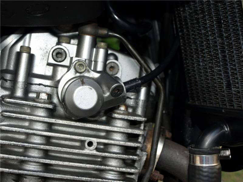

i got one of these from fleabay for about a tenner/ xt 600/500 tacho drive unit,which fits straight on
gallery/pic.php?mode=large&pic_id=623
i got mechanicle tacho (universal tacho) 4 to 1 ratio,ideally topping out at 8 thou rpm for
another tenner from fleabay.see gallery photo. i suppose any make with the correct ratio will do ,i like bmw ones
The cable i made up from
drive side was a xt600 so it fits the drive unit and clock side was anything i had lying around, to get the length the outer
cable had to be measured and spliced where ther were little or no bend and refitted with i bit of
ally tubing and some shrink rap,( use two halves to make required length)
The inner cable was a " universal speedo cable repair kit" this is the inner wire thats 1.5 mtrs long and you custom fit
the square end once its sized up to the new length of the outer cable.

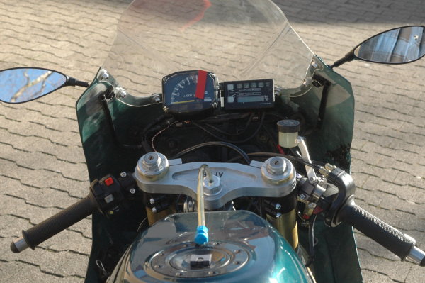

Postby hb7 » Sun Feb 26, 2012 11:18 pm
I have one of these pro cycle autometer and it's rock steady....on my 1998 Skorpion.
Plus it fits in the same hole......
I have a collection of 6 MMB tachs, they all bounce. I replaced the electrolytic capacitors and saw no improvement.
They appear to be well made, but the repair they need escapes me.
