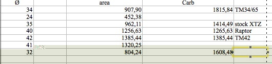

Here some various carb sizes for comparison:
Picture 1.jpg (45.91 KiB) Viewed 1471 times
Keep in mind that the Bikeworx kit delivers a plus of 5hp desite being much smaller in area than the stock carb. This carb setup is used in racing, too. I used it myself and I am pretty sure that Chris Hunsicker is using it.
The TM34B65 is also much smaller than the stock carb, despite delivering much better performnce and much better mileage.
A TM32B65 would be ideal if such a thing was readily available. There actually is a dual Keihin CR 32 (round slide) for the SRX which is ideal but doesn't fit under the tank of the Skorpion without serious modifications.
