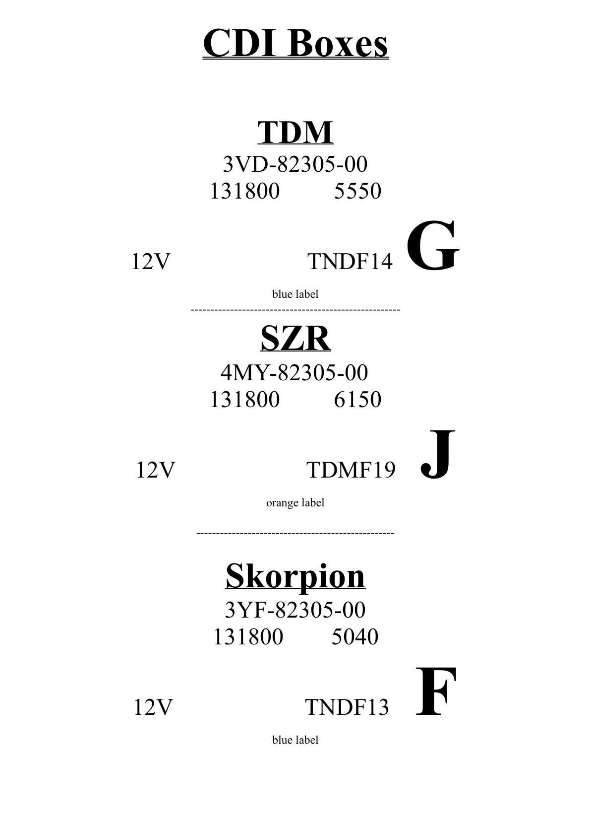

as long as the engine is stock, you can use the TDM box. Its limiter ist set at 8400. But its drawback is the spark advance curve which goes to 40º, more than even the extreme 38ºof the XTZ box.
these boxes all work in the Skorpion. Both the XTZ and SZR boxes can be modified from the stock 7200 to 8400. I have modified the SZR box myself but not the XTZ which has a completely different circuit board.

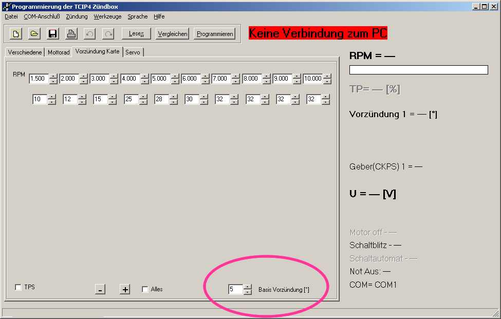

In all cases concerning a modified Denso box, the advance curve is too extreme for very high compression ratios. 30º should be the limit for ratios above 10.5:1.
You are better off using a completely different ignition.
I suggest you try SPARKER TCIP4 standard from Ignitech.
You can program the CDI to suit your needs and it is plug and play as far as the connections are concerned.
I have no experience myself with this but several of my acquaintances do.
When I was still racing, I used first a PVL magneto, later changing to a SilentHektik triple spark constant loss battery ignition. Both worked fine but the SilentHektik started much more easily and had 16 different curves to choose from. The PVL had a an advance of 22º to which the static advance is added, usually 5º, making 27º total. I used the SilentHektik at 28º total advance. Neither can be used with the stock left side of the engine: flywheel and starter have to go. Back on the road and at the moment running a modified XTZ box, I can testify that the racing engine now vibrates much much worse than it did with 28º advance. I attribute this (and others in the know do as well) to the extreme 38º advance. I have not decided what to do yet, but I may get one of those SPARKER TCIP4 standard boxes as well. We'll see.

TRX and TDM boxes are not the same. The TRX has 270º crank, the TDM a 360º crank.
See my posting further above: the TDM box is plug and play:
See also my comments on its use.
See also my comments in other postings about the tach issues involved in using a different box than that installed. (I hate having to continually rewrite...)
As for the Raptor box. AFAIK it is not plug and play. You can make it work when you know which pins are what and you connect it with individual shoes.
I do this anyway. I cannot see any advantage to using that OEM box, tho. One of the several aftermarket boxes offered in the states might be an option but not plug and play.
What do work is the box from the XT (3TB-82305-00-000). It could even be plug and play. And that of the SRX definitely works |9XL-85540-50-00) but not plug and play. It has no rev limiter at all.

Get the IGNITECH box. It has all the advantages you can think of:
-it is definitely plug and play made, specifically for the xtz engine
-it is programmable, giving you any advance curve and any limiter you want
-it is cheaper
Cheaper if you buy it directly from them. The German firm KEDO is marketing a programmable plug and play box for 249€ which, although they do not admit, must be the same box.
