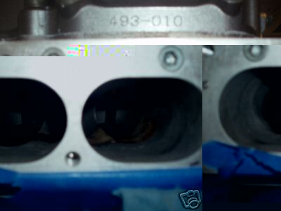

head work changing and enlargening the ports, welding up the intake side and remilling to make it symmetric and to fit twin Keihins with suitable long intake manifolds.
like this
