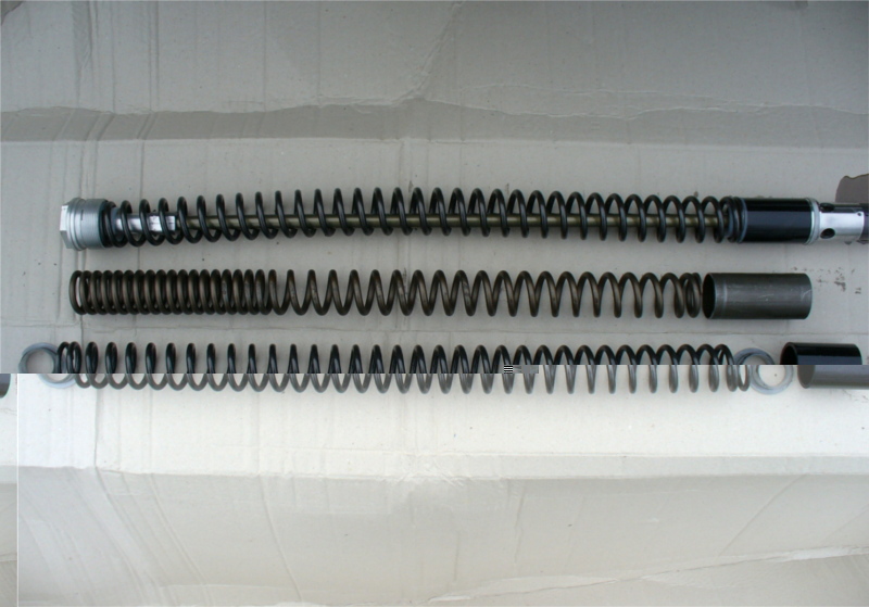

Postby roeleman » Sat Apr 19, 2008 6:21 am
Here is teh picture of the old springs and a new on (in the middle). You can see the progressive ones are a litte bit shorter bu the fill pipe is longer to compensate.
On the lower one You see the plastic caps I was talking about and don't fit the new springs. These ones I gonna make myself and maybe shorten the fill pipe a little bit to keep the same total length. I give the results when finished, but I have to find me first a new set of seals also. Seems it s a special design you have to order with MZ (or Marzochi).
