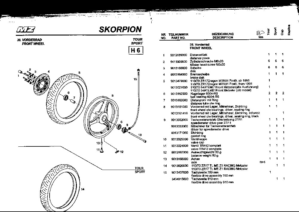

I am trying to get the part number or OEM number for the oil seal in the speedo drive (Left) side of the front wheel.
It's chewed up so I can't see any numbers on it.
Is there a source for a Skorpion parts list / manual anyone aware of? a pdf possibly?

Looking at the front wheel page of the parts book, there isn't a seal pictured, but a 'gasket ring' is listed under the speedo drive gear (part no: 9013171000). I asssume this is the part you're looking for.
You should be able to get this from Grahams Motorcycles.
The manual this is copied from is available from Mike at http://www.mzregalia.com/page4.htm for 10 UKP (c.US$20) plus postage.

Thanks for sending the parts diagram.I'll have to see if i can order one.
Took the wheel off & checked, the seal is pressed in the left side of the wheel.
It sits outside of the wheel bearing. Most likely it is the "gasket ring " you identified.
It runs on a lip on the inner part of the speedo drive.
