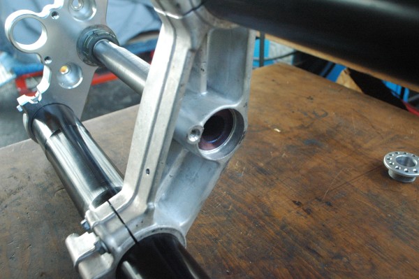

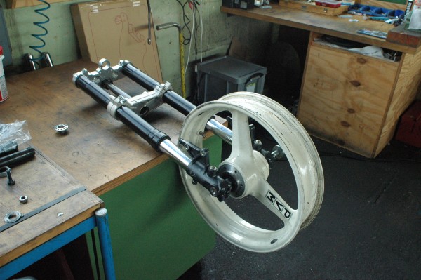

Retrospectively, I do not recommend installing an USD fork unless you are seriously into real racing. For the street, it is a waste of time. My green bike was never a MZ out of the showroom. It was put together from parts taken from a new Skorpion Sport and a new SZR, using the fork, wheels, brakes, electrics and engine from the Yamaha and frame and tank from the MZ. THe frame was later supplanted by a prototype frame gotten from the MZ test shop. In stock condition, however, the Paioli USD from the SRZ is not as good as the RSU from the Skorpion as I learned in the process.
If you can't resist the rebuild look for something better like an R6 front end complete with wheel and brakes. You will need to exchange the steering tube or make a new one to fit. I have done it a couple of times.
Recently I modified a Showa fork from an Aprilia Tuono to fit into an SZR which was mostly turning a new steering tube and shrinking it into the Showa yoke.
here with 3,5" PVM alu wheel installed. The owner opted to use the 3" Brembo wheel instead.
from the bottom of the bottom yoke
