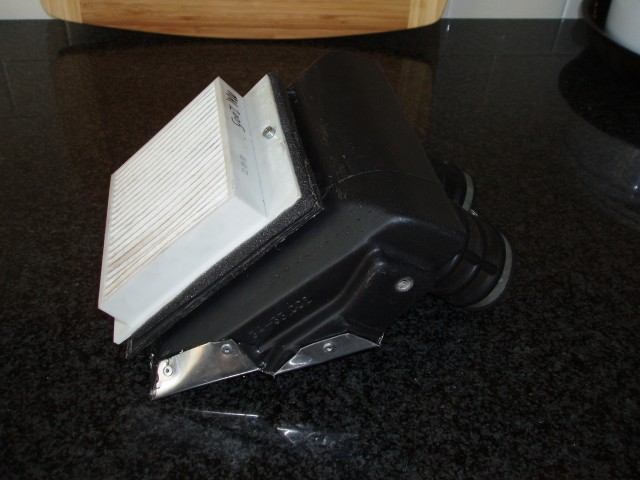

Postby Chris Hunsicker » Wed Aug 15, 2007 7:49 pm
Henri, I'm a low budget ricky-racer. You got a problem with that? :-D
Here's how I ran with a stock modified airbox for a long time. Worked great.
I realize it goes counter to the principles of large-capacity airboxes. I'll leave the reasons why up to the experts.
My main reason for doing this was just to clean up the site lines.
