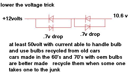

Postby DAVID THOMPSON » Fri Apr 20, 2007 4:52 pm
here is one of my fav tricks to make 12volt lamps run longer
back to back diodes 7/10th volt drop per pair
1.4 volts 2 pair
see drawing below
ps makes bulbs in insterment clusters last a very long time
ar dave
