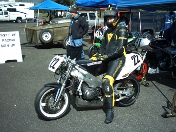

Postby omrra91 » Thu Apr 05, 2007 2:11 pm
The winter project up and running. Just a shack down run without body work and still using a stock motor.
MZ660 motor
Yamaha TZR250 frame
Later model TZR front forks
Yamaha FZR400SP front brakes
Ducati 620 rear wheel
The very first time my team mate ran the bike he took second in a four lap qualifier. Unfortunately when he went out to run Lightweight Superbike he crashed at speed. The bike cartwheeled backwards. The high flying crash did some damage that we are now fixing. Please see my add for parts wanted.

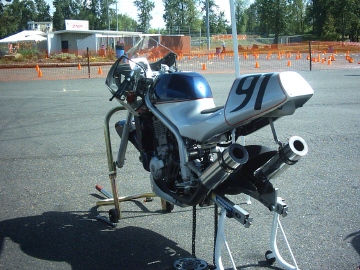

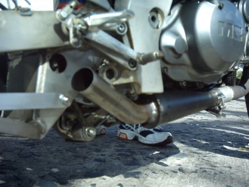

Postby omrra91 » Tue Apr 10, 2007 10:06 pm
Sorry all. I love the direction the conversations are going. I just have my hands full fixing the MZR. Finally found a replacement gas tank. Thank you Mark Brown at GP Customs.
I got the Jemco Hand-me-down from Mark Macek at Corse Meccanica. He has been great to me and my team mate over the last few seasons.
Three things to keep in mind when dealing with Jemco. (1)The telephone is the extent of the technogy that the are currently using. (2)The kick stand mount must be ground off, so forget about Jemco on the street ride. (3)Finally, the picture I am posting shows mufflers on the bike. They are stamped Jemco. But John of Jemco has no recolection of building mufflers. I have a really trashed extra set that I could send Jemco to refresh thier memories. The extras are so trashed, well that all they are good for.
Jeffrey
