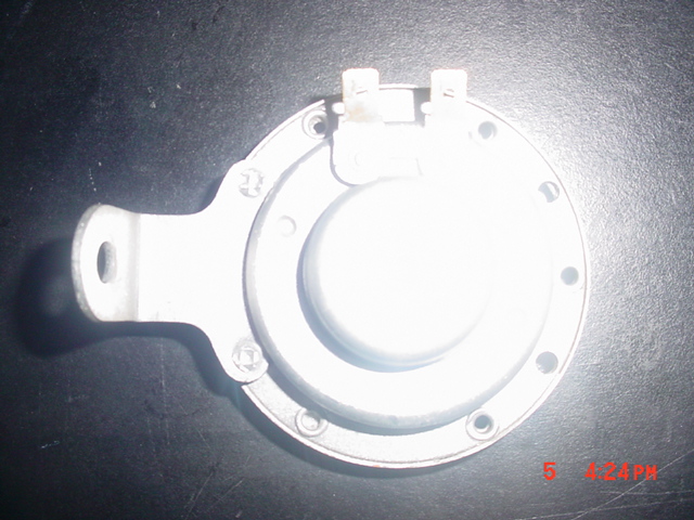

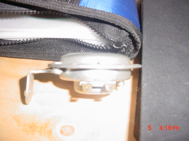

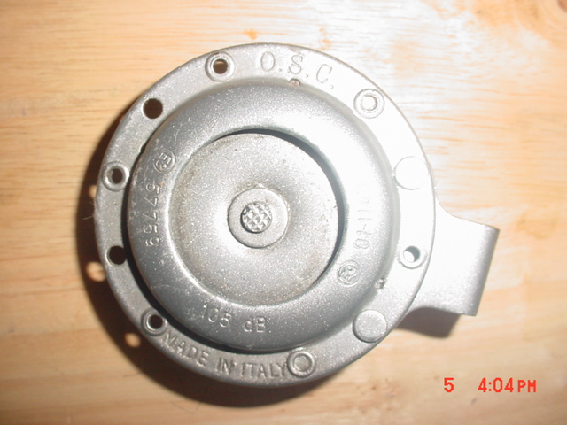

Horn for Skorpion tour 660cc photos
Postby Chayanne » Sat May 05, 2007 3:30 pm
See attached. the unit have diferent numbers:
IN FRONT
01-1143
105 DB
57759
O.S.C.
REAR
12V-1N
OVERALL SIZE
ROUND 3 INCHES
+ HOOK SIDE 3.5 INCHES
HORN BACK SIDE
HORN SIDE
HORN FRONT
Chayanne
Chayanne
Posts: 48
Joined: Fri Jun 03, 2005 8:12 pm
Location: Mayaguez, Puerto Rico
horn
Postby DAVID THOMPSON » Sat May 05, 2007 6:52 pm
try vespa or aprilia dealer or a harley shop that has buell blast
or drill out the ribits and clean the contact points inside
and it may hoot again
but put a 12volt lamp on the wires that feed it ...push horn button with key on and see if it is getting power first
ar dave
