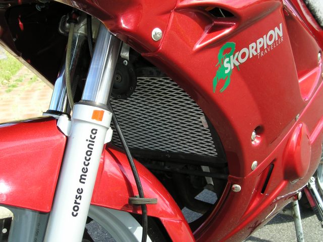

I did mine about 18 months ago. I cleaned the backside of each hole to the raw material with my Dremel, cut a small patch (30mmx30mm) of stainless steel mesh, and then glooped it all over with JB Weld.
Re-drilled the hole, replaced all the original mushroom head screws with polished stainless and cut new plastic washers with a wadding punch, and no problems since. In fact it is better fitting than original and looks 100% too.
The pic shows these screws and washers and my cheeep radiator cowl made from expanded aluminium mesh, and car door surround "U" channel plastic stuff. About $5.00 Oz.
SS screws to fairing and showing cheeep radiator cowl
