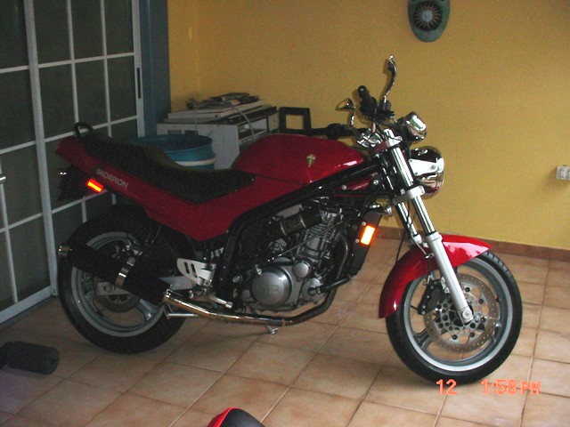

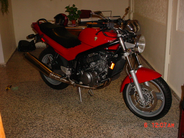

Postby Chayanne » Mon Jun 19, 2006 11:18 am
Changes:
Original Air Filter to a KN Air Filter KA-5087, Exhaust Holeshot (only 2 pounds), Dynojet kit..
Results: ~ 5 HP, excellent performance, Impressive sound ...
With Holeshot exhaust
With Stock Exhaust
