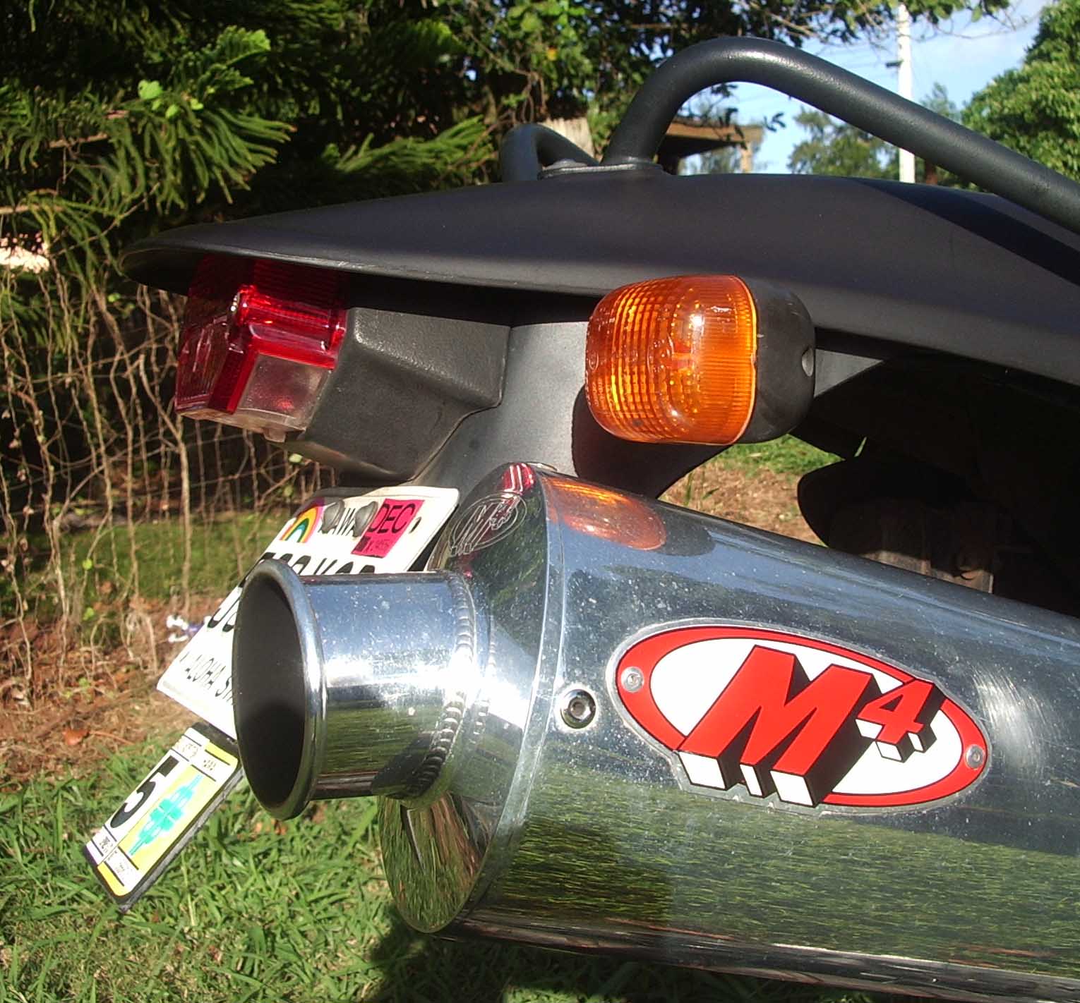

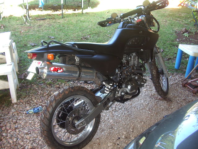

Postby patsoc » Sat Jan 06, 2007 9:56 pm
I tucked the tail section on my enduro today. It took about 1 hour and minimal tools wereneeded. I think it looks alot better than stock. next project is to remove the purge cannister.

Postby patsoc » Sun Jan 07, 2007 3:26 pm
After removing the mudguard, I actually used a hacksaw to cut the tubing and brace at the weld points. This left me with just the square tubing that holds up the rear. After that, the under portion of the mudguard that holds the lights was able to slide all the way forward to tuck under the tail. Then I marked and drilled the where the bolts needed to go through and it bolted right up. I trimmed all the plastic with tin snips. I was considering purchasing a new taillight and signals but this mod was easy and cost me $0.00.

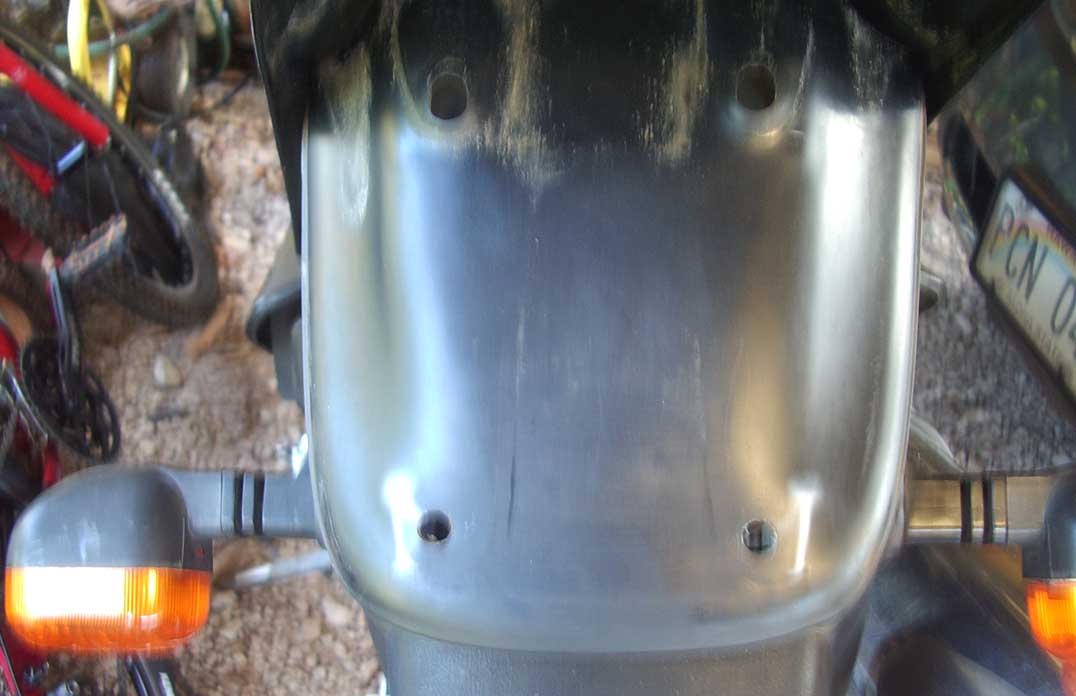

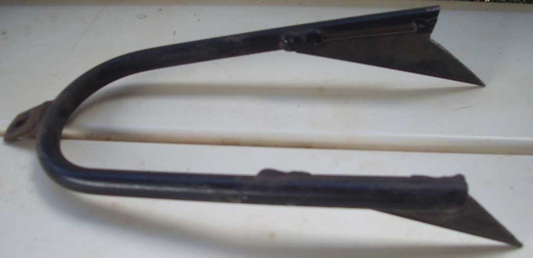

Postby patsoc » Wed Jan 17, 2007 11:58 pm
Here is the under side.
This is what is leftover.
trash bar.jpg (41.03 KiB) Viewed 4514 times
This photo shows the under piece of the mudguard with new holes for mounting bars. When assembled it is covered by the upper piece.
leftover 1.jpg (73 KiB) Viewed 4514 times

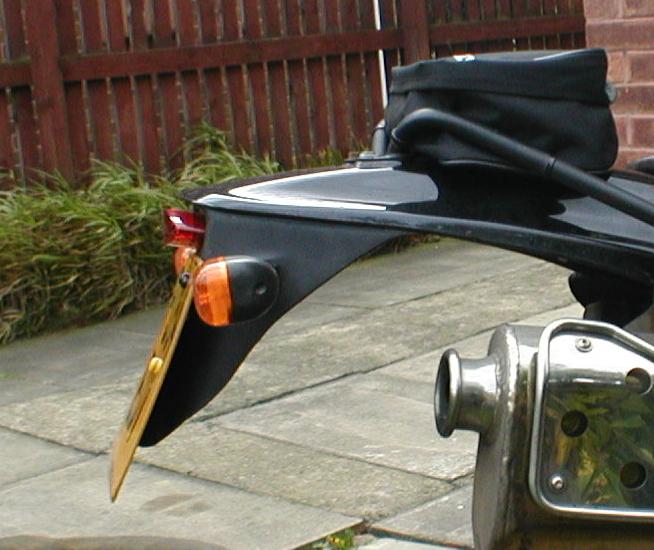

Postby Flipper » Tue Jan 23, 2007 6:38 pm
Nice job, I was thinking of doing something similar myself, I was a little worried if vibration would be a problem after removing the ironwork.
Anyway fate stepped in. I broke the tail light putting her in the garage
I had trouble sourcing a replacement, but found a smaller LED unit at the NEC bike show.
I raised the plate and reshaped the plastic with a jigsaw to tidy it up further
May still remove the ironwork to set things further forward, and replace the indicators with something a little smaller
