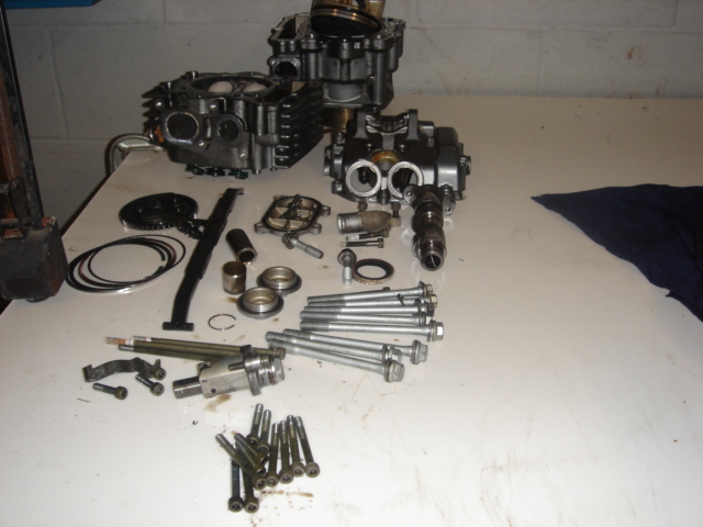

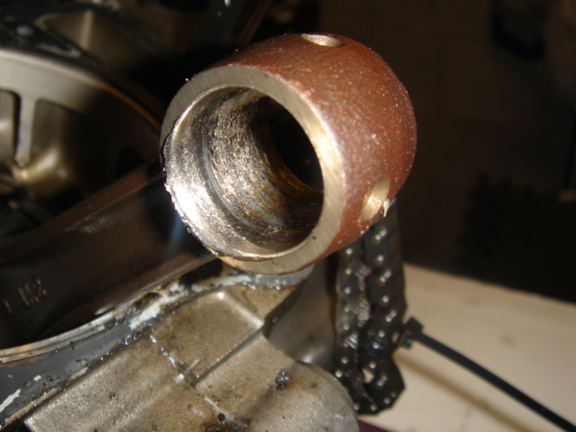

Postby DEmark » Thu Dec 21, 2006 6:21 am
This is what small end rod failure loks like, has anyone else experienced this?
[img]
[/img]
Notice the "two piece" wristpin on the table

Postby Wonky » Thu Dec 21, 2006 8:56 am
Ouch! Nasty... :shock:

Postby OLDMTNCARVER » Thu Dec 21, 2006 10:54 am
DEmark,
I've also got an '01 Baghira with the same mi. showing. It wasn't till this last summer that I finally got my greasey hands on it, WOW, these things are fun!
It's the first single of this type that I've owned and figure that I have to make it last, I'm not rich...
At this time an M4 is on it and soon intend carbs and stay on the outside of the engine. Been gleaning lots of information from this forum with the idea that the bike is a work in progress. I'd hope over it's life to identify points in time/or mi. that changes would be wise to make.
I figured, maybe, at around 20,000mi. I'd start to think of a bigger piston, rod, and other assorted parts, leaving some room again for another build in about the same mi.
The point to my thoughts. To be as wise as I can with the undercurrent that I'm not raceing it.
You posted pictures of the damage and I'm interested in the cause of the failure you determined and wonder why with such difference in the mileage of the two bikes.
I'm inteested in your thoughts with the current MZ you own.
