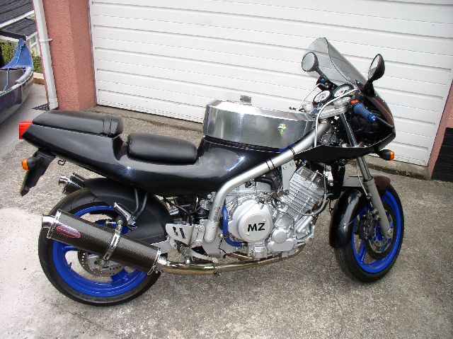

Postby keithcross » Tue Jun 20, 2006 6:30 am
Wow, what motor is that. Look like a Yamaha 750/850/900 twin.
Keith
Ride it like you stole it
keithcross
Posts: 922
Location: Hampshire England
Postby reb » Tue Jun 20, 2006 6:39 am
850
not the best fit in the world - still needs a nice tank making etc
but it has solved the performance shortage of the single cylinder engine
reb
