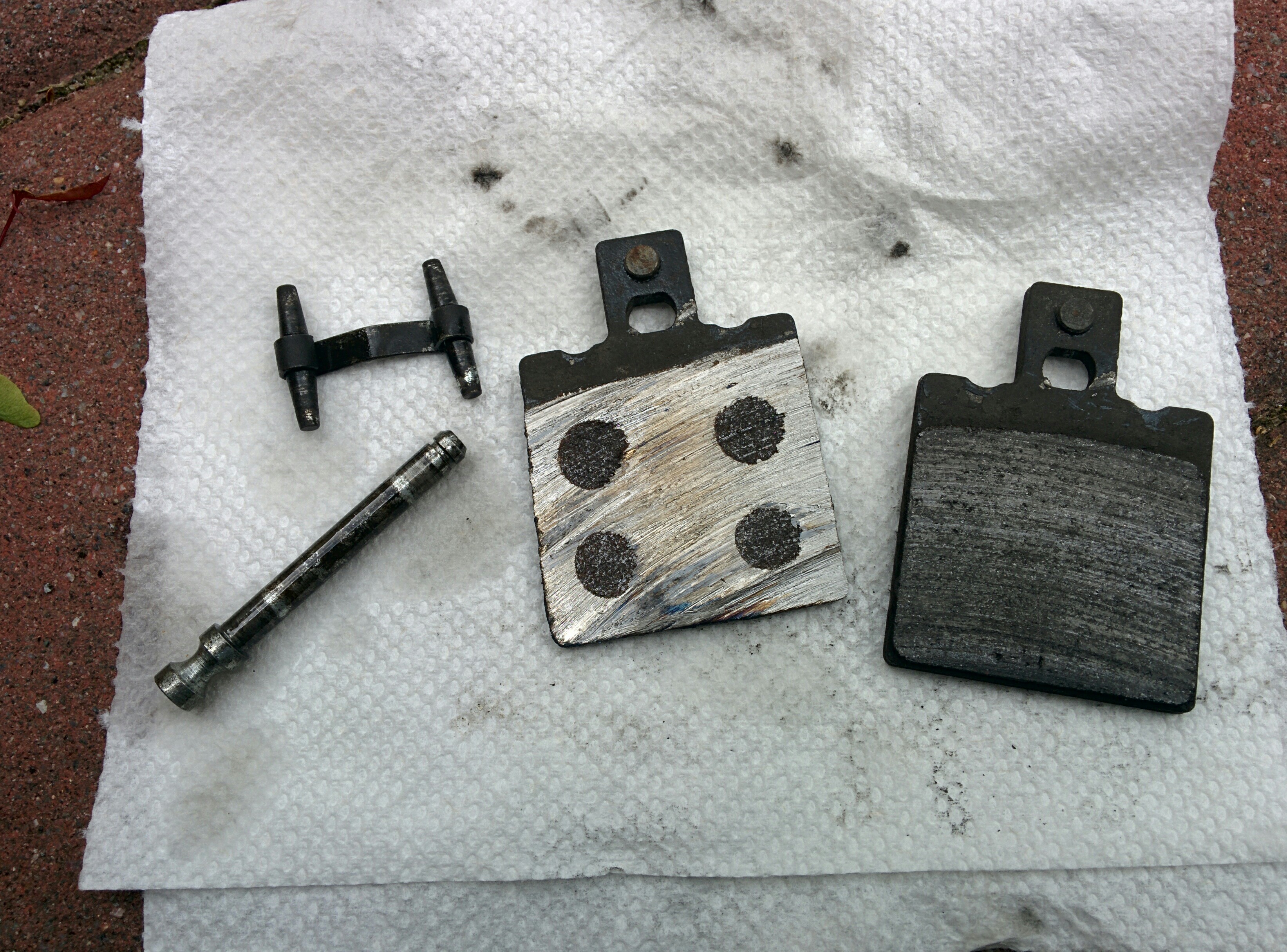

My bike is a 1995 Skorpion Sport and I need to replace its rear brake pads (Grimeca). Has anyone done it lately?

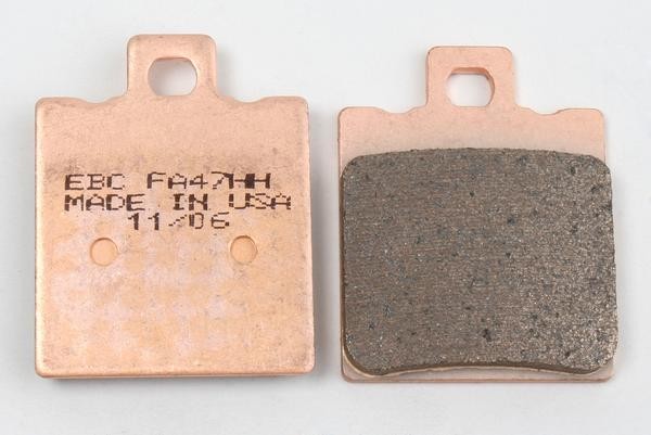

I called EBC USA and they told me to use FA47HH, which look like this:
http://www.amazon.com/EBC-Double-H-Sint ... pad+fa47HH
But they look so different from the old ones:
Old rear brake pads
Has anyone here used FA47HH on the rear Grimeca caliper? Do they fit?

Postby edfmaniac » Thu May 19, 2016 7:16 am
Amazon has a horrible habit of including a picture of the wrong product when it comes to things like moto parts. If you do a Google Image search for the model number that EBC gave you, it turns up pictures of their pads with the model number printed on them.

Postby WaiNYC » Mon May 23, 2016 6:00 pm
Sad to report, i was unable to install the new EBC rear brake pads. They simply would not slip in the slots where they belong.
What can I do if the spacings between the rotor and caliper are too narrow (the old brake pads were almost completely worn out)?
Should I let out the brake fluid?
WaiNYC
Posts: 88

Re: EBC Brake Pad Question
Postby guitarzan » Mon May 23, 2016 7:31 pm
You just need to press the piston back into the caliper. Unless it is really stuck, you can use your thumbs. It shouldn't need the bleeder opened for that.
