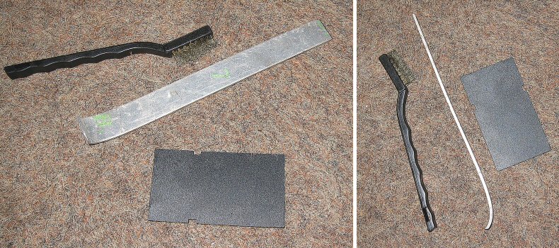

Postby andyw » Sun May 14, 2006 5:16 am
IT RUNS!
..........new top end sounds quiet and smooth. So far all I've done is run it up to temp in the garage and leave it running for a few minutes more - so far so good. Will let it cool and then do the same before going for a gentle run :D
Cleaning combustion chamber, valves and piston crown - did use some carb cleaner but not sure it made much difference. The job was pretty easy with a bit of care using:
# An aluminium scraper (just a piece of aluminium sheet cut to 20mm wide, bend a bit of a curve at one end and then chamfer both ends to make a sharpish scraping edge)
# A small brass (NOT steel!!) wire brush
# A thin piece of plastic as a second scraper
CARE - if cleaning the piston crown in situ (i.e. barrel still on engine) mask up the edge of the piston and barrel to make sure no debris enters the waterways or ringland.
Also took the time to grind the valves/valve seats in and put new valve stem oil seals on.
