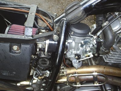

I wanted a single carb (A CVK40 `pumper` carb) and started going down that route at one point. I thought the port centre-to-centre distance difference between the Grizzly manifold and the MZ head to be too much for an adaptor plate to accommodate. I also found i didn`t have the space within the frame (Mastiff) for it all to fit!

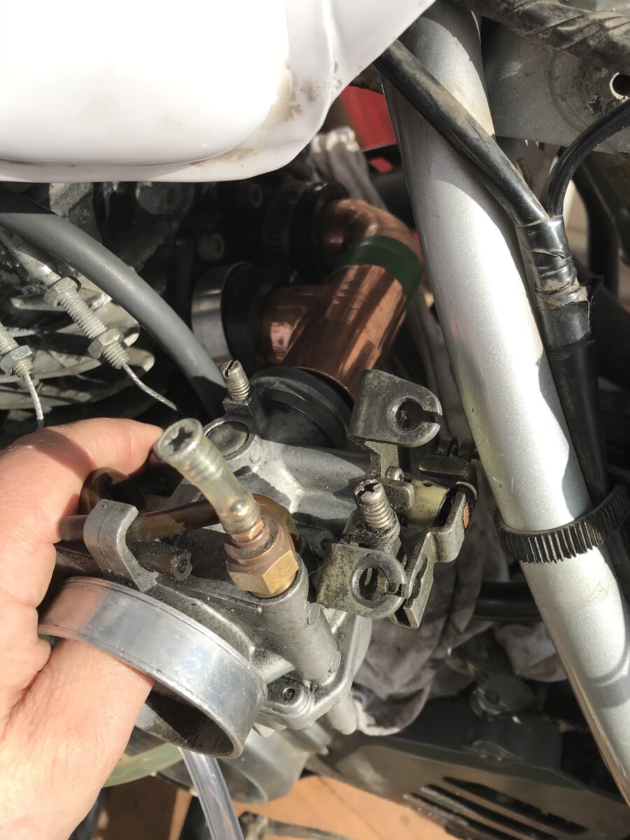

I ended making my own Heath Robinson version, I`m trying to find a picture of it but here is the RH side -
Cheers.

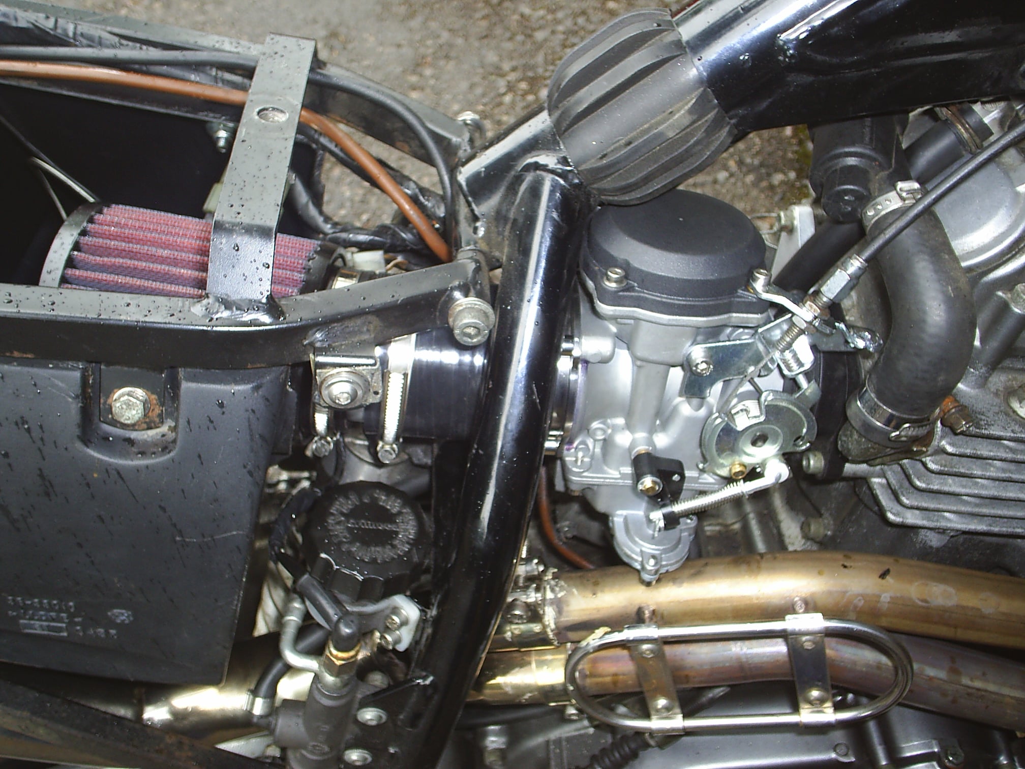

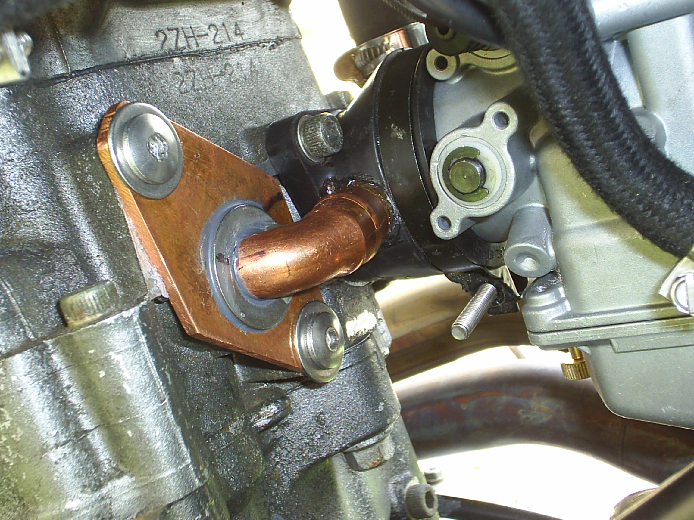

Postby breakwellmz » Wed Apr 17, 2024 9:03 am
Here is the image I was looking for. Don`t laugh, it works for me!
Certainly not the `performance` upgrade I think you may be looking for, but the benefits for me are. -
1/ - Far better starting and idle.
2/- Increased low/midrange torque (So much so I had to raise the gearing to make first gear usable!)
4/- Improved fuel economy.
5/- Much quicker off the line.

Your setup looks really nice !
I didn't know that was the case with the grizzly manifold :cry:
I already have a BSM end can on the bike and have changed the main jet on the main (small) carb from a 130 to a 135 with the mixture screw 5 or 6 turns out I cant remember exactly, the bike runs great and can consistently hit 95mph, though I would really like it to pull the front wheel up in 1st and maybe 2nd more.
Basically as much torque as I can get from it without drastically affecting it's reliability.
With your setup, would the missing carb not cause issues with lower air volume entering the engine ? Of course the air now has a much greater velocity which probably outweighs the lower volume especially when the throttle is open. Also, what is the copper tube to the other intake actually doing ? It seems like its at a very odd angle and would struggle to capture much air and fuel from the other intake boot but of course it works for you !
And finally, what kind of jetting are you running ?

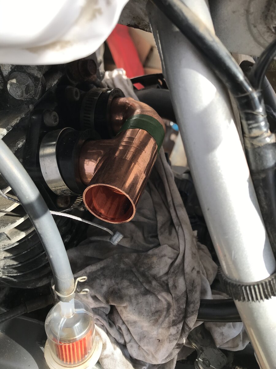

The copper elbow supplies the smaller of the two inlet ports.
Increased inlet charge velocity due reduced carb area is exactly the reason the torque is produced at lower revs, I do have slightly less `top end` though I`m sure
What also improves throttle response greatly is the fact the the CVK40 is a CV carb with a "pumper", a good all round sort of carb in my opinion.
I have got all the bits now to proceed with this sort of thing, just need more time! -
