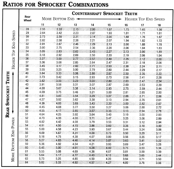

Changing Sprockets and high way Ridding
Postby Chayanne » Thu Mar 30, 2006 6:41 pm
Attached please find a table that is very useful for that desicion...
The front sprocket more larger is higher top speed and the Rear sprocket is the opposite....
State your actual ratio and take the desicion base on that.
Actually I'm working inn change my ratio (MZ Skorpion Tour 660cc 2002 sprockets 15-39. This bike is very powerfull in the wide RPM range but I want to put the bike more faster along the range. I'm troubleshooting that right now...
Let me know if you have more imformation about this theme...
Thanks
Ratio and Sprocket Combinations Table...
