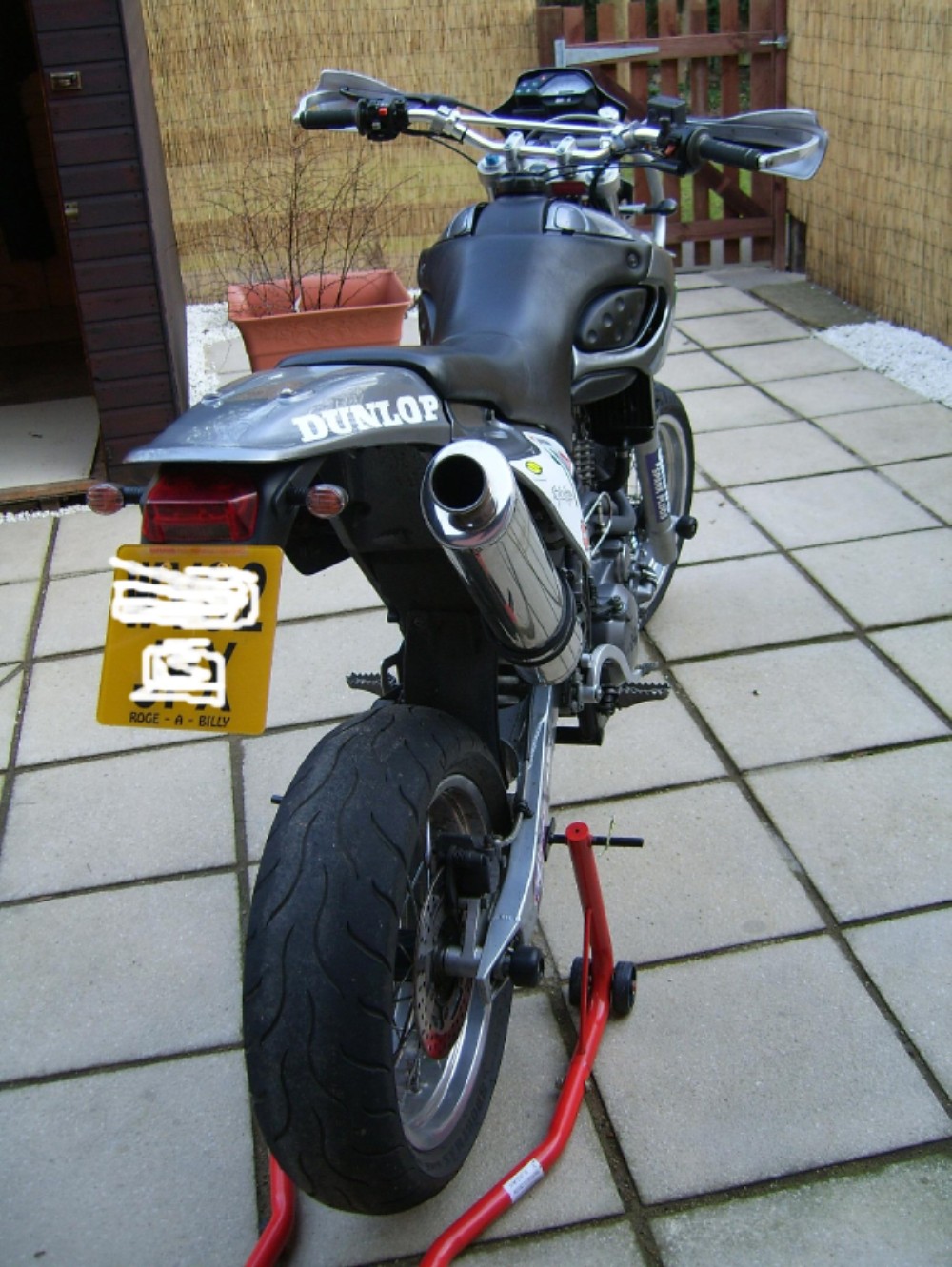

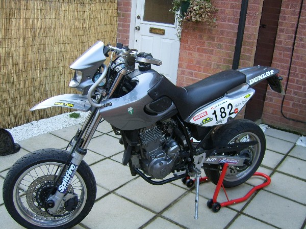

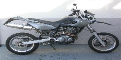

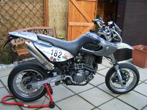

Postby roge-a-billy » Fri Mar 03, 2006 3:37 pm
before and after
sucks
better
Up to my knees in gin & hookers

From front to rear:-
R1 brake disk, axle crash bungs (solid axle drill & tap to fit) Acerbis supermoto mud guard, Hand guards, in board mounts off E-bay rap round bars by owner, ally moto-X bars, Domino grips, Split fire plug, NGK silicon lead, Both carbs lifted up a notch on the needles and mix screw turned out 7 turns from closed ( still slight popping on over run so really needs a jetting kit :roll: ) adjusted so CV carb opens just after primary carb. Rubber strip top of air box removed, But might put it back to try and richen it back up. Exhaust from box to twin pipes cut and rewelded by owner for a pattern so an adault could then weld it professionally ( http://www.predatormotorsport.co.uk). Carbon Can Co exhaust (came with the bike :-D ). Exhaust bar the can sprayed in BBQ paint (cheeper than exhaust paint just as good) because.... well I like it! White panels done by a local company, not easy so many curves caused white panels to crease alot so he had to get special vinyl in, at no extra cost. Stickers picked up her and there (moto-X and off road show) mainly free. Acerbis rear guard and mini flashers came with bike. Axle crash bungs on rear

Postby cat » Sat Mar 04, 2006 9:54 pm
It looks good. :D
Next time get the cat in the photo. :wink:
Take a close-up of the disc, please - I wanna see how it's done. The caliper mount looks stock from here - is it a bigger disc?
The Acerbis tail piece works ok, that's quite a good way to solve it.

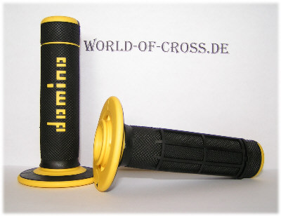

Where did you get the Domino grips?! :shock: I've just been searching for them - now. I gave up :( ...there's only one place that has them, it seems - carpimoto, but they only come with the throttles - I was about to email them and ask if I could buy just the grips - but now I'm looking at their rear wheel stands. And it looks like they only do UPS, which would cost way too much.
The rubber strip you mention, on top of the air box - d'you mean that strip of car door sealing stuff? I wondered how air was supposed to get in. I drilled holes in mine.
Did you do the sliders yourself? I know phlat mentioned it once, used a drill press, but I want to know how deep and so on.
There's..some..tip about the carbs - I've got it saved, but I think I posted it here - it involves raising one needle and lowering the other. So that might help.
Thanks for the photos. I wouldn't mind some more. :D Get the cat in too, like next to the front wheel..I think it'll match the bike. :lol:

Postby roge-a-billy » Sun Mar 05, 2006 6:35 am
As Kieth says The front disk was a straight bolt on. I went to the Big UK bike show (N.E.C Birmingham) and asked the EBC brakes stand the cost of wavey R1 disks, 124.00 pounds and he also quoted numbers for a 320mm disk when I said it was for a supamoto. They were very suprised and interested when I said it fitted MZ Baggi's and wrote it down for future ref'. R1 disk is lighter and does give you better brakes, bought of E-bay 11.00 pounds all in.
Domino grips off E-bay from some one braking a CCM Duel sport, some would say the CCM had fell to pieces and he was sell what was left :wink: 5.00 pounds all in
As kieth says I go steady messing with the carbs/ breathing and just start with bits I can replace first eg:- rubber strip lift needles etc, Have now got a 135 main jet which I will be putting in soon.
Axle bungs, I drilled with the axles still on the bike VERY carefully have used long M8 bolts, but drilled the hole deeper than the than the length of the bolts. If there is a bike/floor interface and one brakes off your going to have to drill out remaining bolt to start again.

I like those grips. There're some nice yellow and black ones but it's a German site and they also only ship DHL and I'm not paying e13 for the grips and then double that again for the shipping. The guy at Carpimoto said they don't sell the grips without the throttles because it takes months to get them and they like Ariete grips, which are supposed to be the hottest thing for sportbikes.
Domino Griffgummis mehrfarbig - YELLOW.jpg (26.97 KiB) Viewed 6068 times
