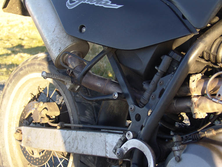

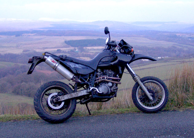

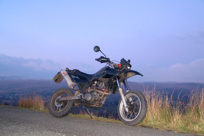

Judge me not- attached is my dirty hoe in her winter best. Went over the mountain earlier and took a few snaps. I will finish cleaning more than the front wheel shortly!
I used connector pipe that came with the M4 silencer and a friend with a wielder! Mine looks a tad shorter which I thinks equals more grunt but less revs? Got Bernds header pipes and carb kit installed too.
Its not rust, its dirt!
j

Not sure of the exact mountain, its up behind a village called upper cwmtwrch, its possibly the black mountains/ brecon beacons in the distance. Some great supermoto lanes!

i've been thinking - about xhausts - a lot - and i think maybe the upswept ones are better because the connector pipe is shorter, like the stock one. the stock goes straight to that lower..cat-like box, which adds volume right there ... the volume of the stock one is more - apparently, by the size of it at least - than any of the aftermarket ones. i'm not very impressed by any of the aftermarket ones. the stock one has to go, because it's so heavy, but i don't want to change the power curve ...and most of the aftermarket ones just don't fit so nicely anyway; they don't tuck up under the bulge of the sidecover. the GPR seems to - apparently / from what i've gathered - perform well, and the M4, but the GPR looks silly, it's way too long, and the M4 is made for the Mastiff and is too low. if i could just go buy one, i wouldn't worry so much, but i've got to deal with people by email and pay a fortune to get it shipped and then pay 10% duty + 14% VAT, so it's very expensive - too expensive for what they are. GPR wants 150 euros for shipping, and BSM wants 30 only but didn't reply when i asked what shipping method that was (like maybe it's surface mail that takes 3-4 months and then maybe doesn't arrive at all.) it probably wouldn't cost any more to buy an Akra slip-on for a KTM or something and get a connector made locally. at least it would be different.
anyway :) ..excuse the 'exhaust rant' /obsession. ...did your friend use pre-made bends or bend some tubing?

irishnutjars wrote: I think he had a little bend 'lying around' as you do. Didnt take him too long but he knows what he's doing! He may replicate it if there was a bit of interest.
I may yet get interested - I'm straining my brain with the options, what I should do. But I've pretty much decided that I don't want a long connector pipe and the can sticking out way back - or halfway/nowhere like the M4 connector. Meanwhile - when you get enough light - and the time and so on - practise your close-up photography and please take a close-up of it. :D

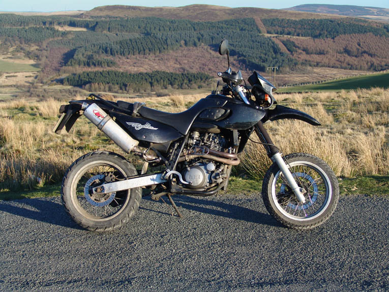

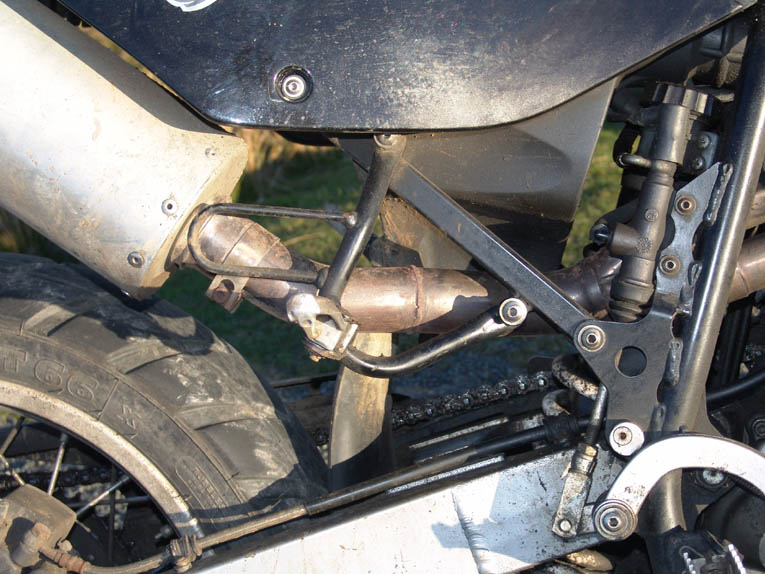

Hi Cat,
Some photos at last- hope they help. Go for it I say- Checking my memory and looking at the pipe again it looks like a realitively simple cut and shut job with the M4 set up.
I think the angle option is great personally, it really follows the lines of the bike and is a little change from the norm! I could'nt beleive my eyes when I fitted the standard M4- I thought someone was having a laugh at my expense!
From memory we put the exhaust in position and marked the pipe to cut it, then connected the cut off 2-1 section with the pipe on again; marked and cut, refitted tacked in place to wield up off the bike (me mostly pointing and bolting and unbolting!).
I wish I took a pic of the indicator after my journey home- talk about a mess- do remember to fit flush fit indicators or something before this stage!
One more shot of bike now with 'seal saver' type things attached which kinda brings us round the circle! Wish I'd got them ages ago!
