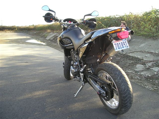

Postby phlat65 » Mon Feb 20, 2006 11:31 pm
the reflectors are glued on.
I used the stock tail lamp on mine, and BMW E46 side repeaters for turn signals. I made a little bracket for them, and they sit at a 45 deg angle to the rear, so they can be seen from the side also.

Postby phlat65 » Tue Feb 21, 2006 11:29 pm
the lenses are available at the BMW car dealer, I want to say they were $12-15 each. I did cut the round loop bar below the lense, and re-welded it so that it is vertical, and welded on some tabs to hold the license plate. I did this to shorten the rear, and so my dual exhaust looks cleaner.
the lenses just clip into a cut out in the fender, so you just have to make a peice of flat sheet with the cut out to clip them into. they are available in amber and clear lenses.
