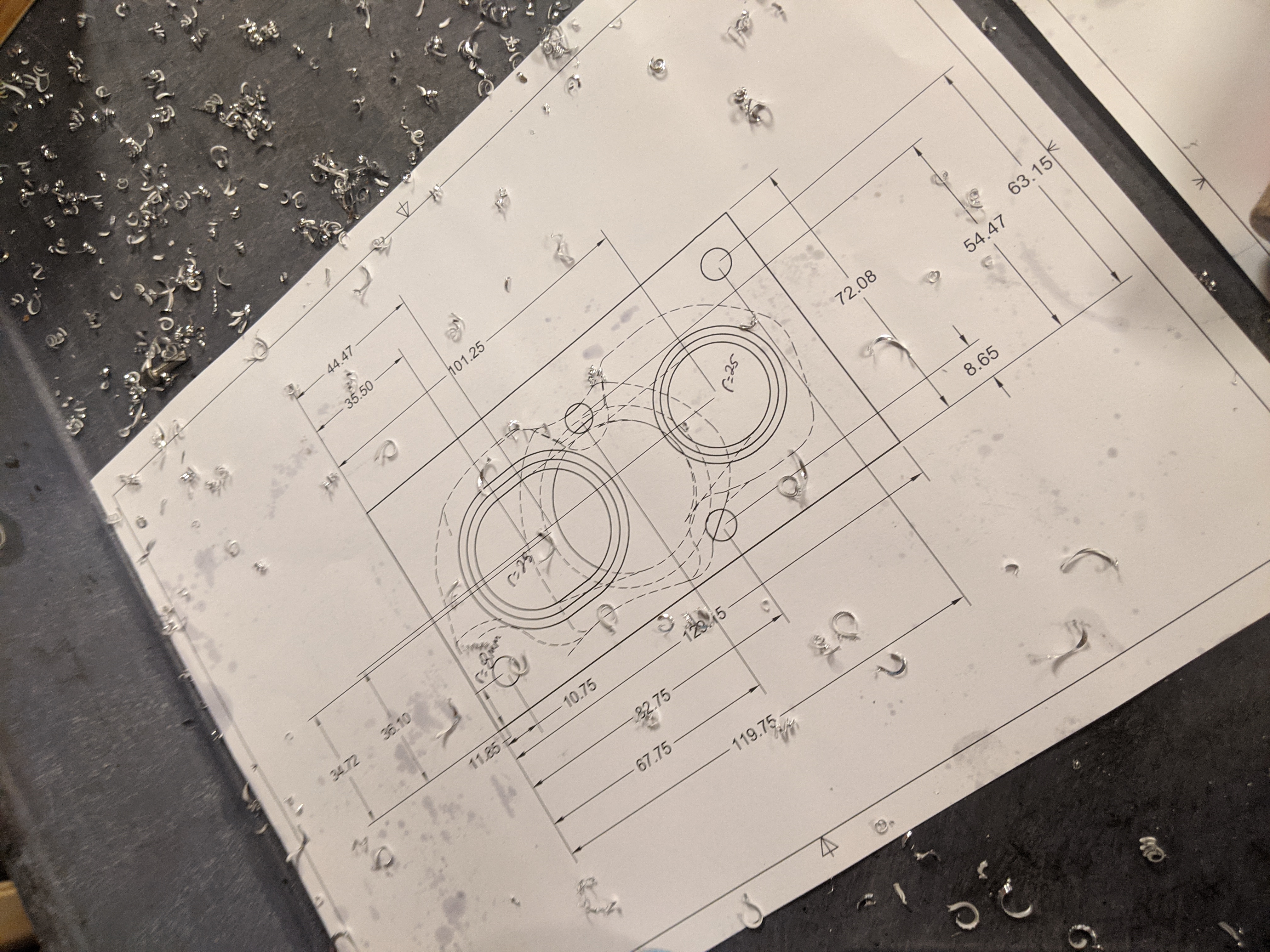

You may well have seen this -
Re: carburetors
Postby buckscreek » Wed Jul 19, 2023 5:28 pm
breakwellmz wrote:You may well have seen this -
I've seen and am using a similar drawing, sourced from another MuZ owner here is Australia, who probably received it from someone in Europe. My machinist called last night, he has completed the work on the main flat plate (as shown on your drawing), he's going to mill the face off a Grizzly 660 intake manifold today, ready for welding to the plate. We'll have some further internal machining/cleaning up to do to ensure we get as smooth a flow of fuel/air mix as we can from the end product. I'll post some photos when I have all the bits together, ready to install.

Postby breakwellmz » Sat Jul 22, 2023 7:19 am
I started going down that route at one point, but thought the hole centre distance difference between the Grizzly manifold and the MZ head to be too much for the (10mm plate in my case) to accommodate. I also found i didn`t have the space within the frame (Mastiff) for it all to fit.
Keen to see how yours pans out.
