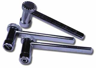

Always right tools. This time around I've got money - or at least compared to when I was 20 - so I go buy the tools. All I need now is a torque wrench that does 5-20Nm - and the valve clearance tools.
I think I've got pictures...there are some Wurth feeler gauges for valve clearance but they're quite hard to get, and about $27 for set of 2.) Then there are the Motion Pro ones - they're available all over the place - the web, I mean. They're not the old usual angled feeler gauges - which I haven't seen for years - since everything started coming from China, probably.
The Motion Pro ones ($4.35-4.75) (see picture below):
TAPPET FEELER GAUGE .002-.003
TAPPET FEELER GAUGE .004-.005
TAPPET FEELER GAUGE .006-.008
Also picture of Motion Pro tappet tool set; it looks good.
Motion Pro tappet feeler gauges (dual-star.com $5).jpg (119.02 KiB) Viewed 8732 times
Motion Pro tappet tool.jpg (5.36 KiB) Viewed 8731 times
cat
Posts: 596

When I last checked my valve clearances I used a set of tappet adjusters like the ones in your picture. They are very easy to use. As for feeler gauges I bend some normal ones to fit.
Keith

Postby cat » Fri Jan 06, 2006 2:18 am
keithcross wrote:When I last checked my valve clearances I used a set of tappet adjusters like the ones in your picture. They are very easy to use. As for feeler gauges I bend some normal ones to fit.
Keith
Yes, that's what we've always done with feeler gauges. The tappet adjuster tools, the only way I'm going to get any is to order them from the USA and they're heavy, so expensive. Maybe I can get just the square type.
cat
Posts: 596
Location: South Africa

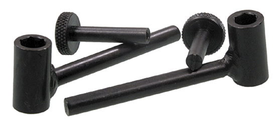

However, pitposse has copies. Which of these is the right one?
Posse Tappet Tool Set 9mm & 10mm
9mm & 10mm SOCKETS, 4mm SQUARE ADJUSTER, SINGLE CYLINDER AND MULTI-CYLINDERS.
MOST HONDA/YAMAHA.
Posse Tappet Tool Set 8mm & 10mm
8mm & 10mm ROCKER ADJUSTMENT NUTS SLOTTED AND 3mm SQUARE ADJUSTER, SCREW DRIVER & 3mm SQUARE-TIP APPLICATIONS.
KAWASAKI MODELS NINJA 600, 750, 900, 1000.
Posse tappet tool set 9mm nut, 10mm nut, 4mm sq (pitposse.com $20).jpg (29.76 KiB) Viewed 8622 times
cat
