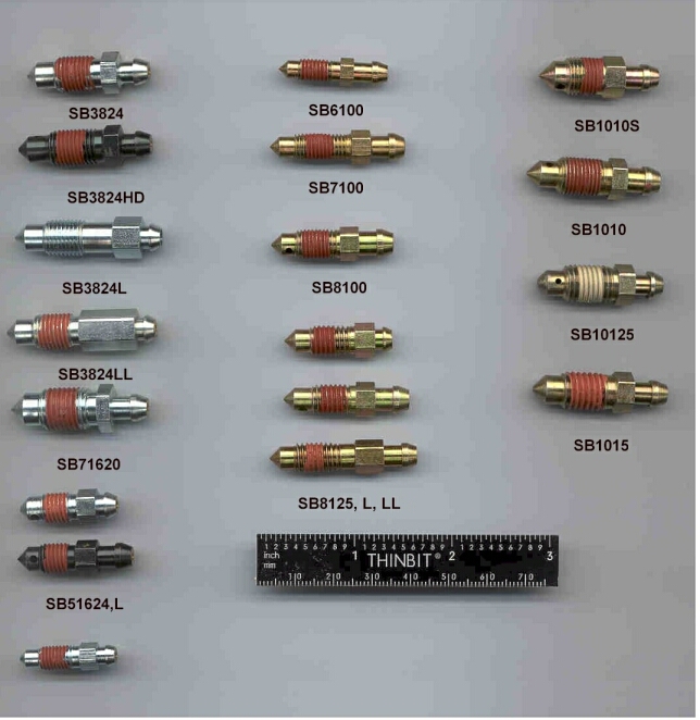

have you tried Speed Bleeders?
apparently they really work well. i bought some for the GS project but i never used them. if i can find out what the thread size of the MZ Grimeca ones is, ...i might be able to use them. or if i knew what other bikes use the same calipers - like some Ducati, maybe.
$7
SPEED BLEEDER®, the patented bleeder screw with the built-in check valve. It is truly a one-person bleeder screw. Once installed, it becomes a permanent part of the brake system.
When it is time to bleed your brakes, you loosen the Speed Bleeder 1/4 turn and pump your brake pedal. When the pedal is depressed the pressure generated opens the check valve letting air and brake fluid out of the end of the Speed Bleeder. When you release the pedal and it returns to the up position, the check valve closes and prevents any air from re-entering the system through the Speed Bleeder.
When bubble-free fluid is evident you close the Speed Bleeder. In the closed position it works just like your stock bleeder screw and prevents any brake fluid from leaking out. It generally takes about 5 pumps to purge each caliper or wheel cylinder. That is all there is to bleeding your brakes. If at a later date you need to bleed your brakes, the patented thread sealing system makes it easy to open the bleeder screw to perform the bleeding operation.

Postby phlat65 » Wed Dec 21, 2005 10:34 pm
without the thread sealing compoound, air will leak back through the threads, thats why I recomend bleeding without the check valve.
2001 MZ Black Panther
phlat65
Posts: 735
Location: Seattle
Postby cat » Thu Dec 22, 2005 2:22 am
phlat65 wrote:without the thread sealing compound, air will leak back through the threads, thats why I recomend bleeding without the check valve.
but won't that happen even with the looped tube?
the syringe method sounds good, because it's more like the brake specialist thing where they have those pump machines. (or any good car service place, i suppose.)
