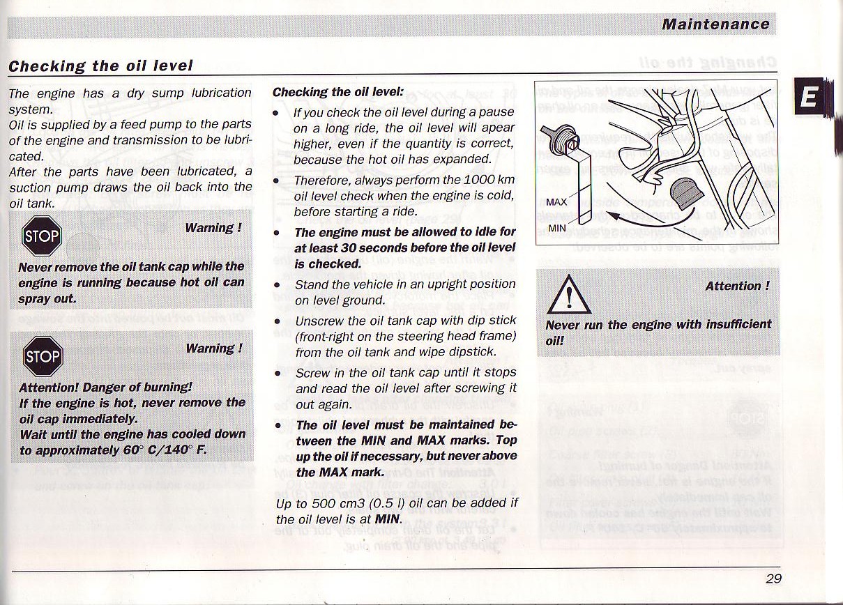

Since this is a dry sump engine, there is no oil stored in it. Rather, it is all in the frame. It would follow then, that when the engine has recently been run, some oil is still in the engine, so the reading you get out of the frame tube will be lower. So, what is the method supposed to be? I tend to follow factory instructions in these situations. In this case, they want the oil checked with a cold engine. That would indicate that you indeed have too much oil in your bike. No problem though, as you can simply drain some out and then top up to proper level. Photo of that page attached if I can get it right.

Postby Fil » Sun Dec 11, 2005 12:43 pm
Thanks for the reply Paul. I followed the exact same procedure in the handbook (as you have reproduced :-) ), and this is what was giving me the funny readings. Today I sucked some of the excess oil out of the frame tank so that without having run the engine at all, the level was just below 'max'. I then ran the engine for about 5 minutes, let it idle for at least 30 seconds and switched it off. I read the oil level, and it was just below the 'max' mark.
I'll keep an eye on it anyway - it just seems odd that I was getting such a low reading after following the directions in the owner's handbook...

the oil expands quite a bit when warm, also the bike needs to idle for the 30 sec or longer for the scavenge pump to stabilize the engine level. I check mine when the frame tank is quite warm to the touch, but not hot.

I've had exactly the same difficulty getting a reliable reading as the OP. I've been advised by a specialist who tuned the bike for me to ignore the manual and let the bike warm up thoroughly before checking the level, then it should be just (only very slightly) below the max. This seems to work fine and also give consistent/reliable readings.
