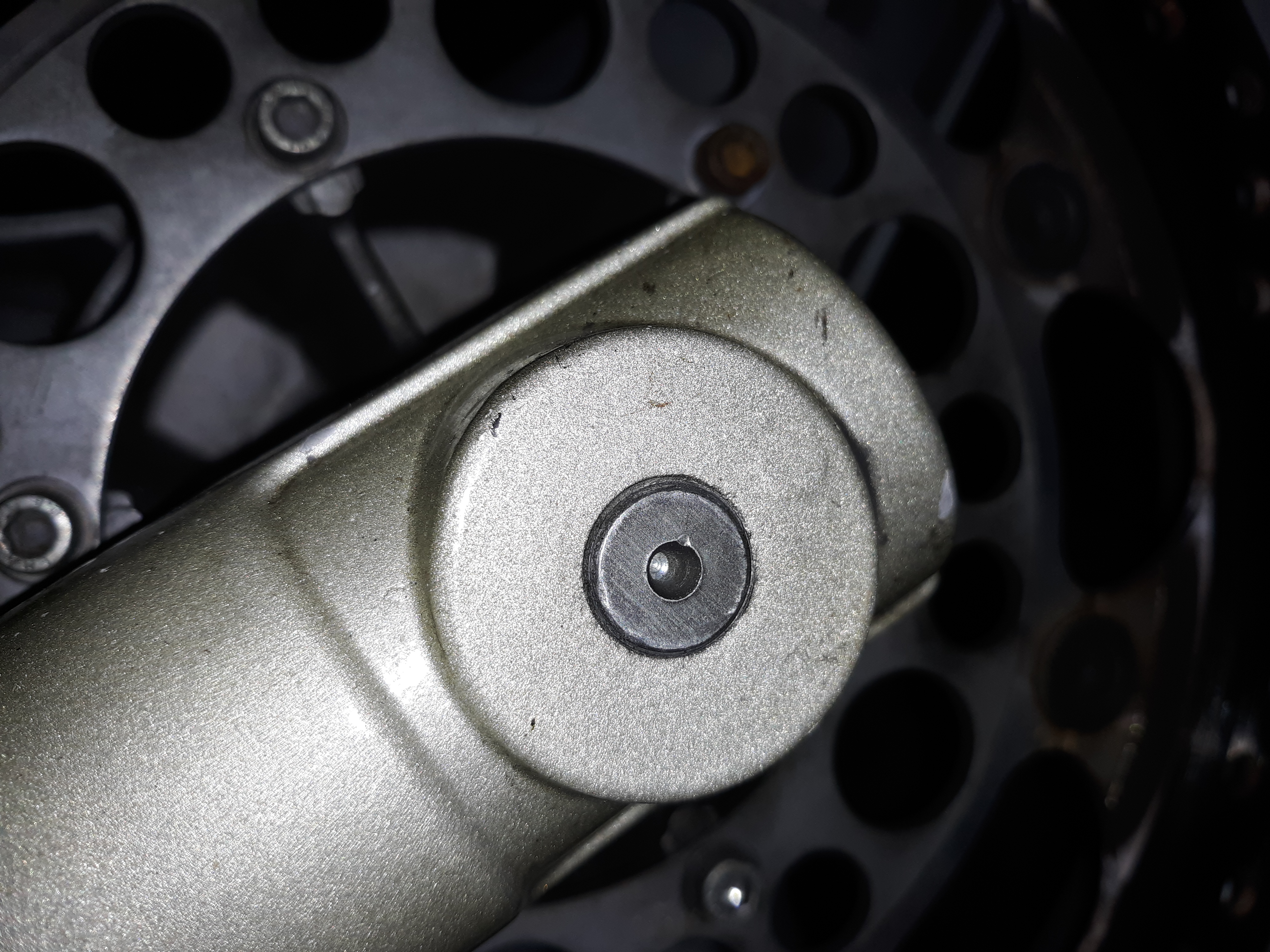

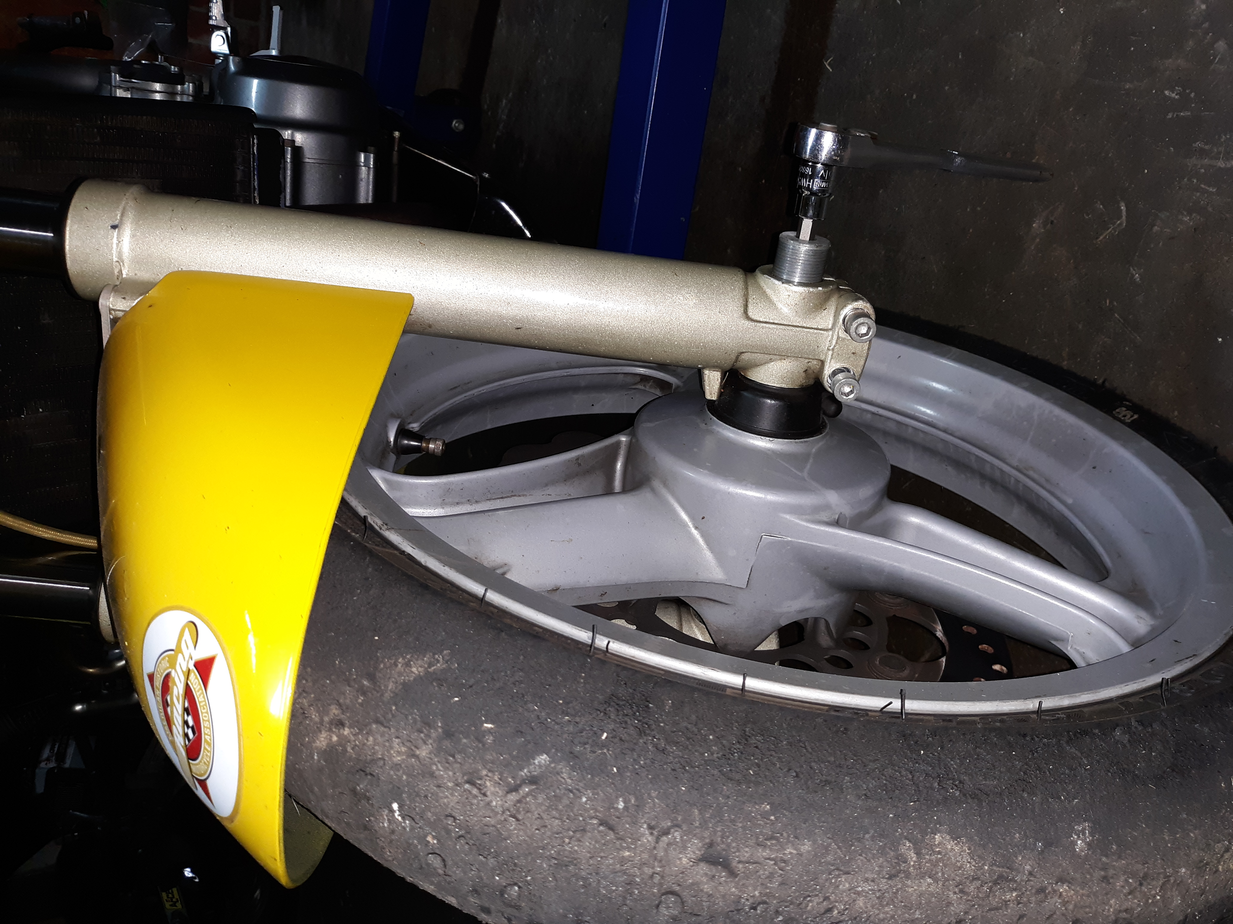

Hi fellas , 660 skorpion front wheel axle removal . I have loosened the 2 allen head pinch bolts on left fork leg and not sure what is next and wanted to check before I proceed.

it is screwed in has threaded end
it is some times hard to get back in on install
make sure wheel is off the ground when putting it back
wiggle top of wheel going back in
axle has threads nut is made into bottom of fork leg

just getting home and thank you , i was worried about whichway to turn the allen axel head in the end of the left side fork ( i am known for breaking stuff ) it came right out and again thank you sir.

Easy peasy , loose the allen pinch and counter clockwise on the 5/16 allen threaded axel . Thanks again dave
