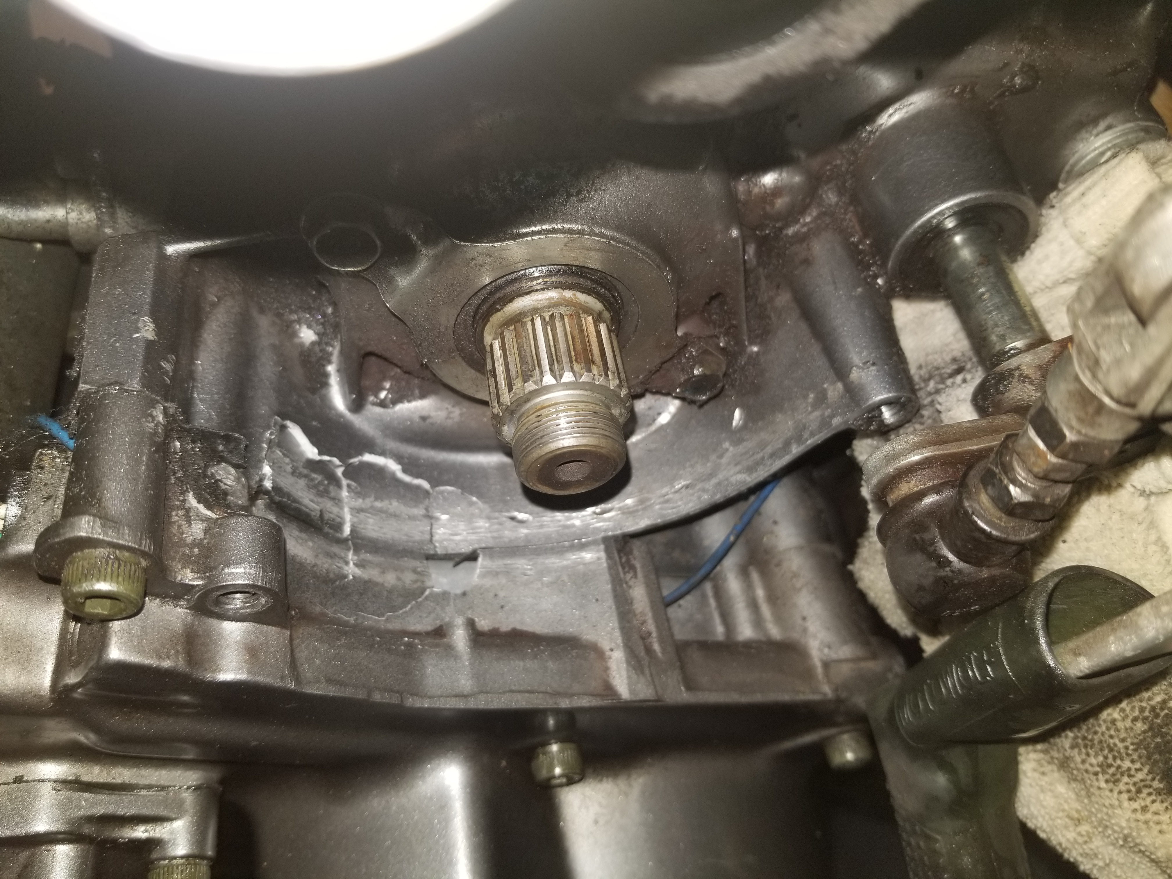

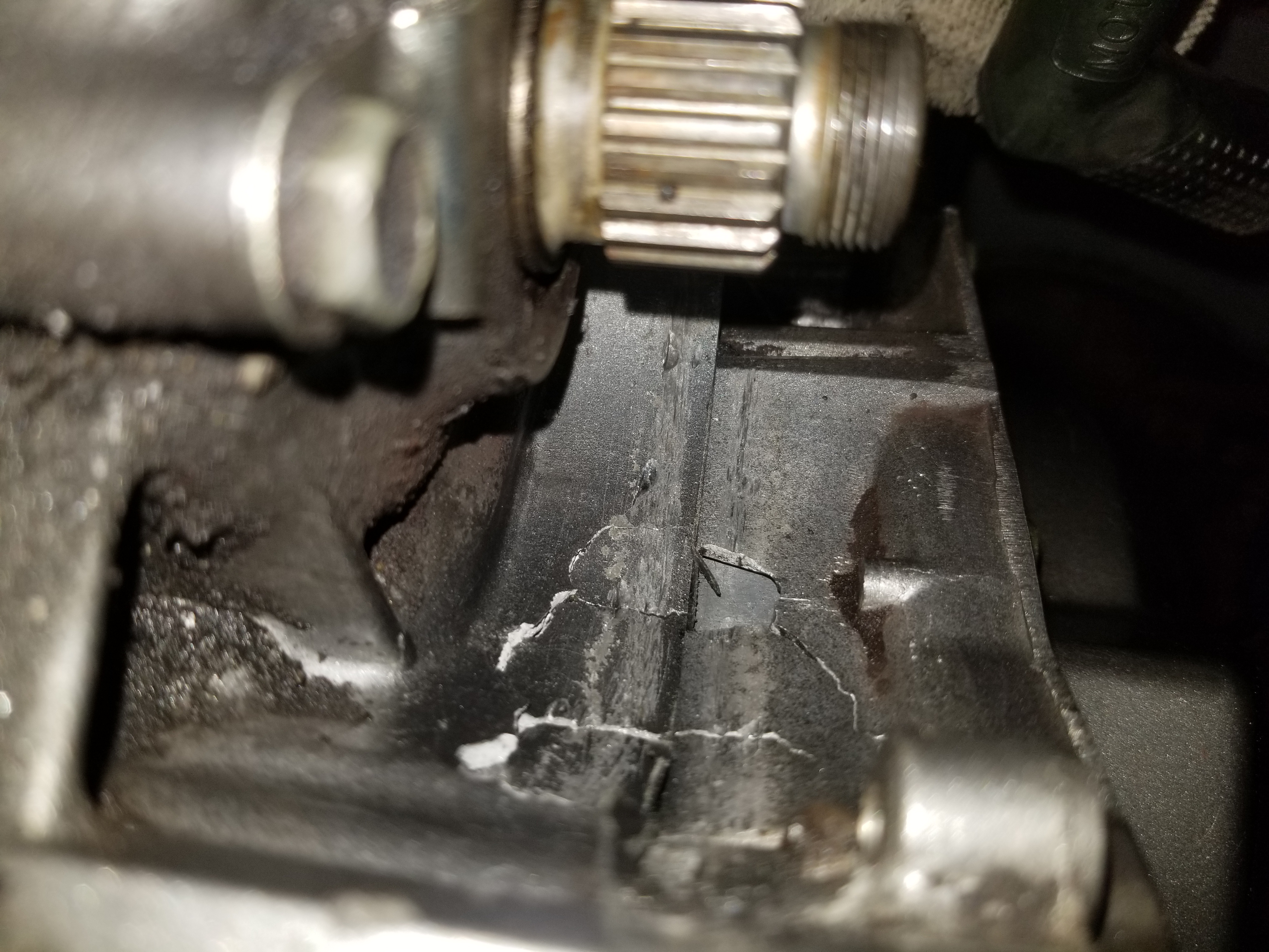

Honest opinions... besides I'm a lousy chain maintainer.
Chain snapped and smashed...
Should I JBweld or use a different epoxy to fix these cracks?

I'd grind out what you can an JB Weld. Hope you don't get a oil leak. That a case replacement otherwise

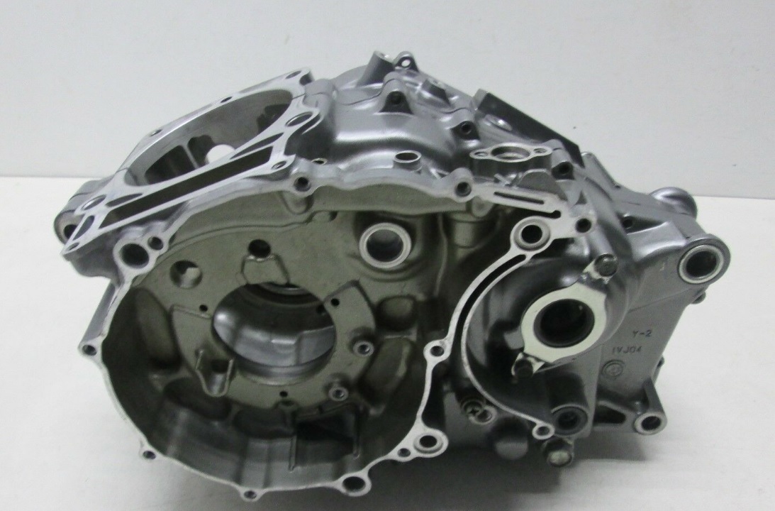

I found this pic off ebay Germany. looks like the case is not compromised.

Looks like you`ve only damaged the built in case saver then, lucky!

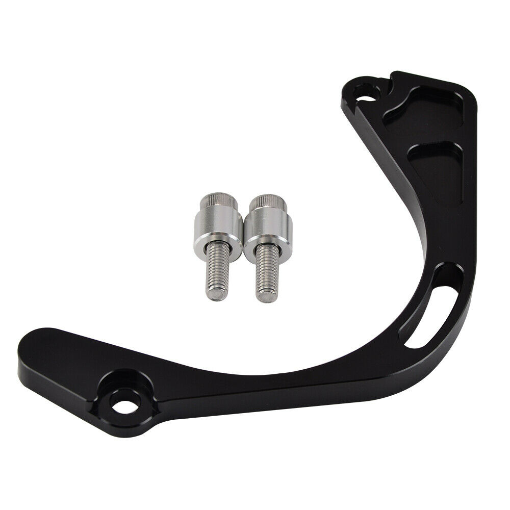

Thank you very much. I didn't know these existed. Do you have a link? I found a Raptor saver. Think this will work?
https://teamalbaracing.com/i-23900131-y ... e-red.html

m4panther wrote:Thank you very much. I didn't know these existed. Do you have a link? I found a Raptor saver. Think this will work?
Hi.
I did buy one for a Raptor and no it didn`t fit. :cry: But looking at the photos we have a built-in one anyway. :D
