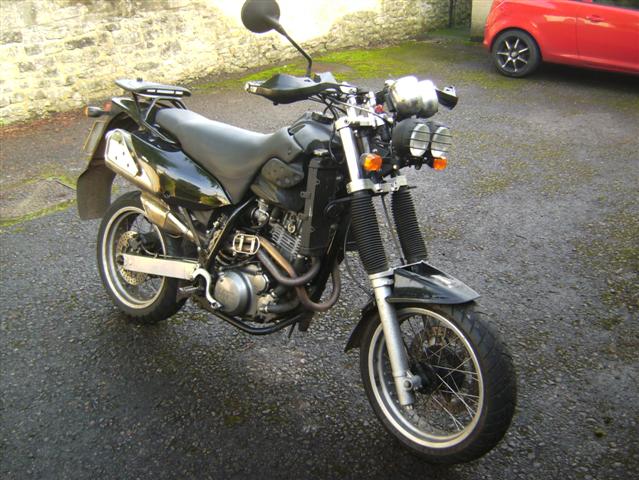

Hi, have managed to secure a mastiff fork brace / lower mudguard support to fit on my baghira, other than looking nice does it actually offer any difference in handling ?
has anyone ever compared it with / without the brace, as its quite thin material i would have thought it doesnt offer a great deal of rigidity, i been thinking of getting a thicker middle plate made, and either sandwiching it together or putting one plate on top and one on bottom.
also has anyone got any suggestion for fork stone guards to use with the mastiff fork brace ?
i currently using these on my baghira and didnt really want to lose thier functionality but if the fork brace is worth fitting i willing to dismiss using fork protectors

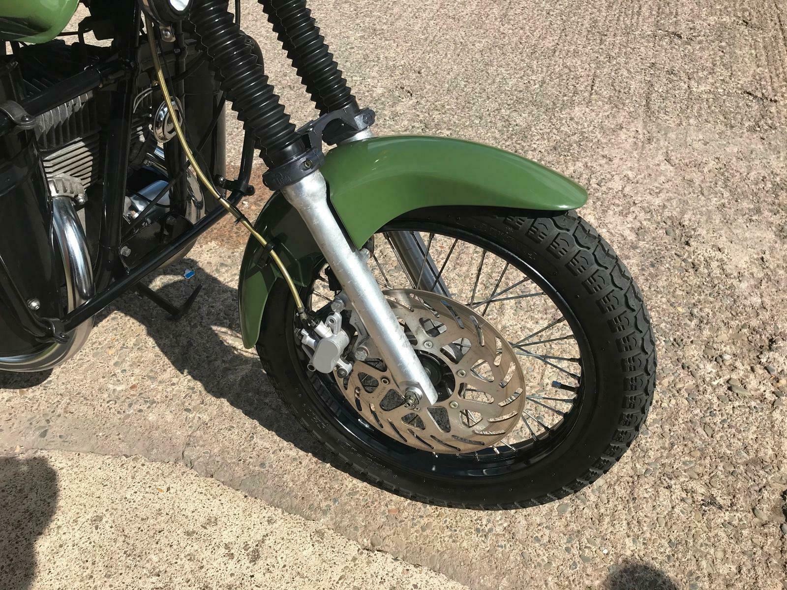

I wouldn`t call mine a brace but simply a mudguard mount as it`s only 3mm (?) thick and only secured by four M6 bolts.
I`ve had rubber bellows type fork protectors on my Mastiff since new rather than the sort you have there and the fork legs look like new.
Cheers.
PS. This is much more of of a fork brace -
