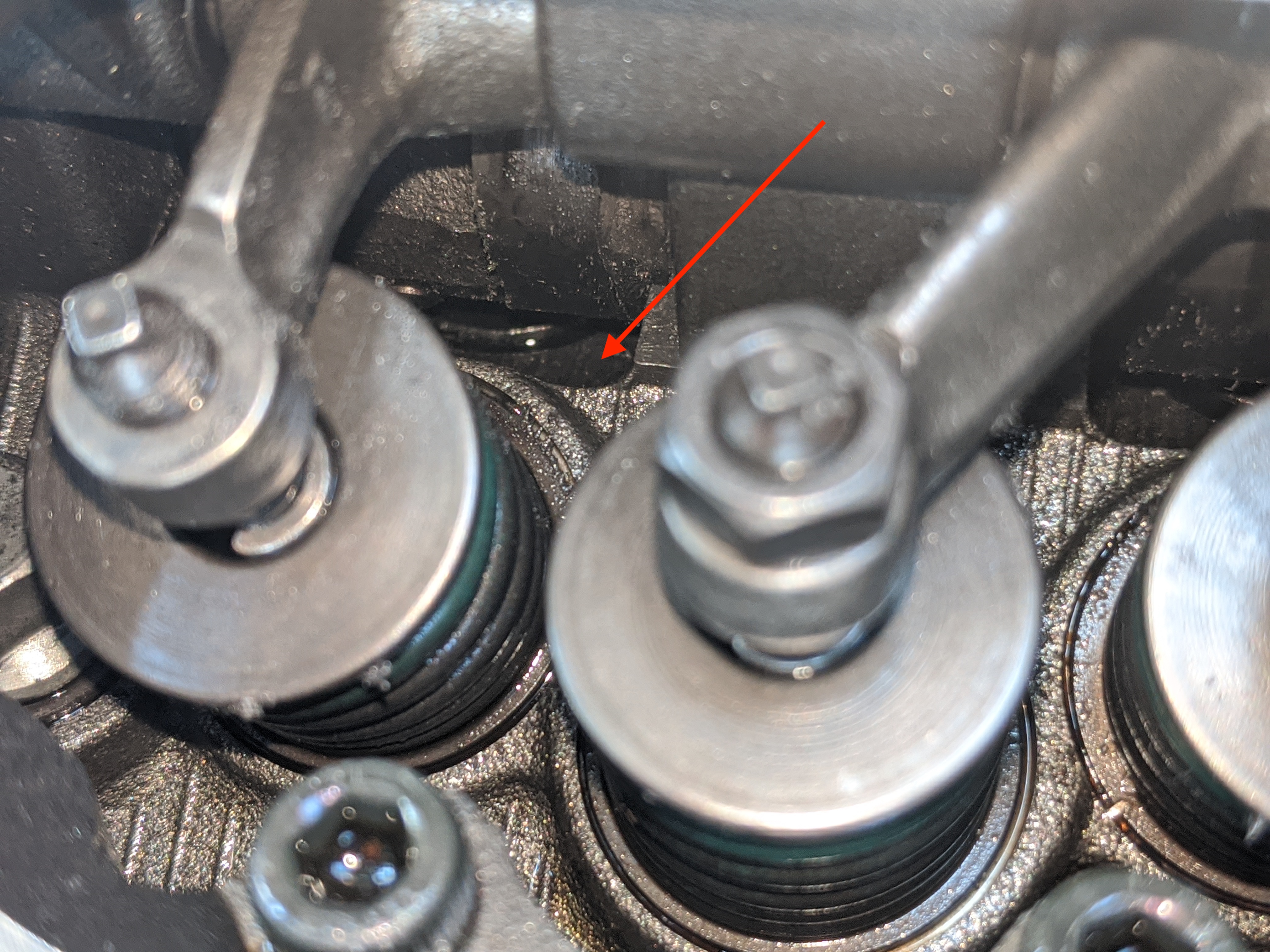

viewtopic.php?f=3&t=10804&start=15 ) is that while adjusting the clearance, I had a small nut dropped into a space inside the valve chamber. Here:
I am trying very hard to suppress anger at myself for the stupid mistake and my dismay at the implications, and trying to look at this as some lessons in mechanics. And I have three areas of help that I need from the community here.
The piston is in the TDC position when the nut went into that gap. I used a magnetic pick-up tool but I could not find anything because the magnetic tip is tad too big to go deep inside. I am now trying to buy a smaller one. The lost nut is small, and the magnet does not need strong pick-up power, but It needs to have a small magnetic tip : the one i have is 8 mm in diameter and 27 mm long.
Help number (1): If you know a pick-up tool that has a smaller magnetic tip, I would greatly appreciate a reference.

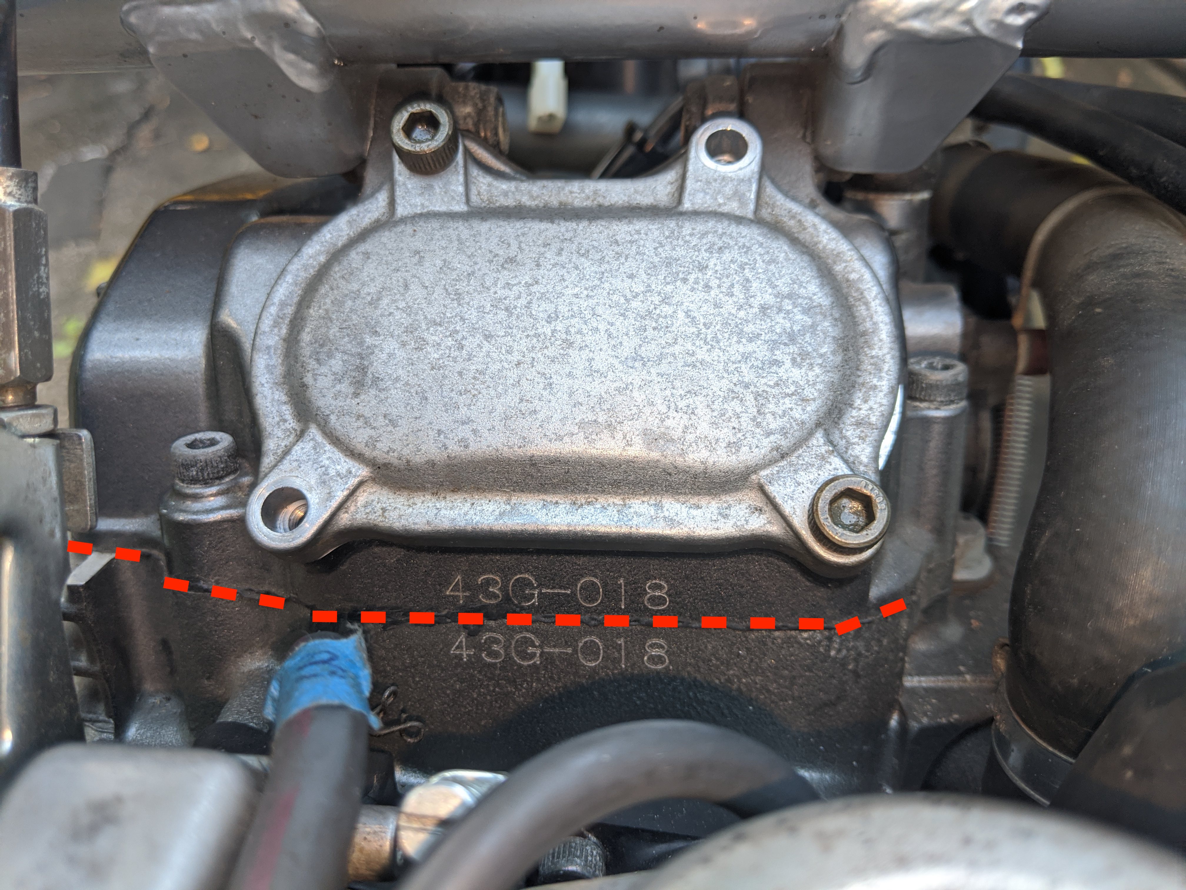

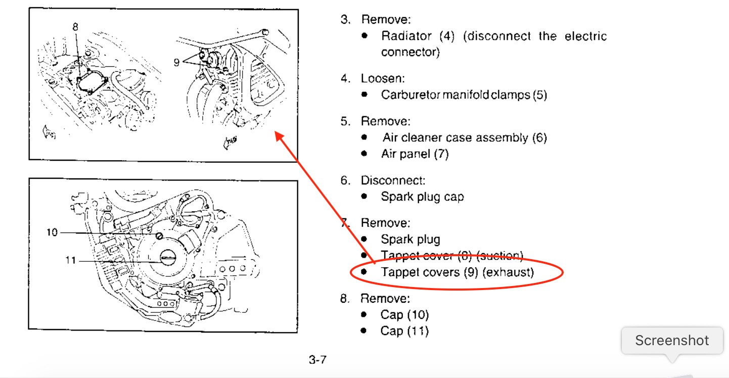

I am also researching for getting an understanding of the anatomy of this engine. (Help number 2 --> ) Given that it's at TDC and where the nut is dropped, where do you think the nut is? If I can't fish it out by going inside this gap, does it make sense to rotate the wheel (in 3rd or 4th gear now) and try to move the nute to a place where I I may be able to reach it with magnets thru the spark plug hole? Or thru the exhaust tappet openings (diagram below)?

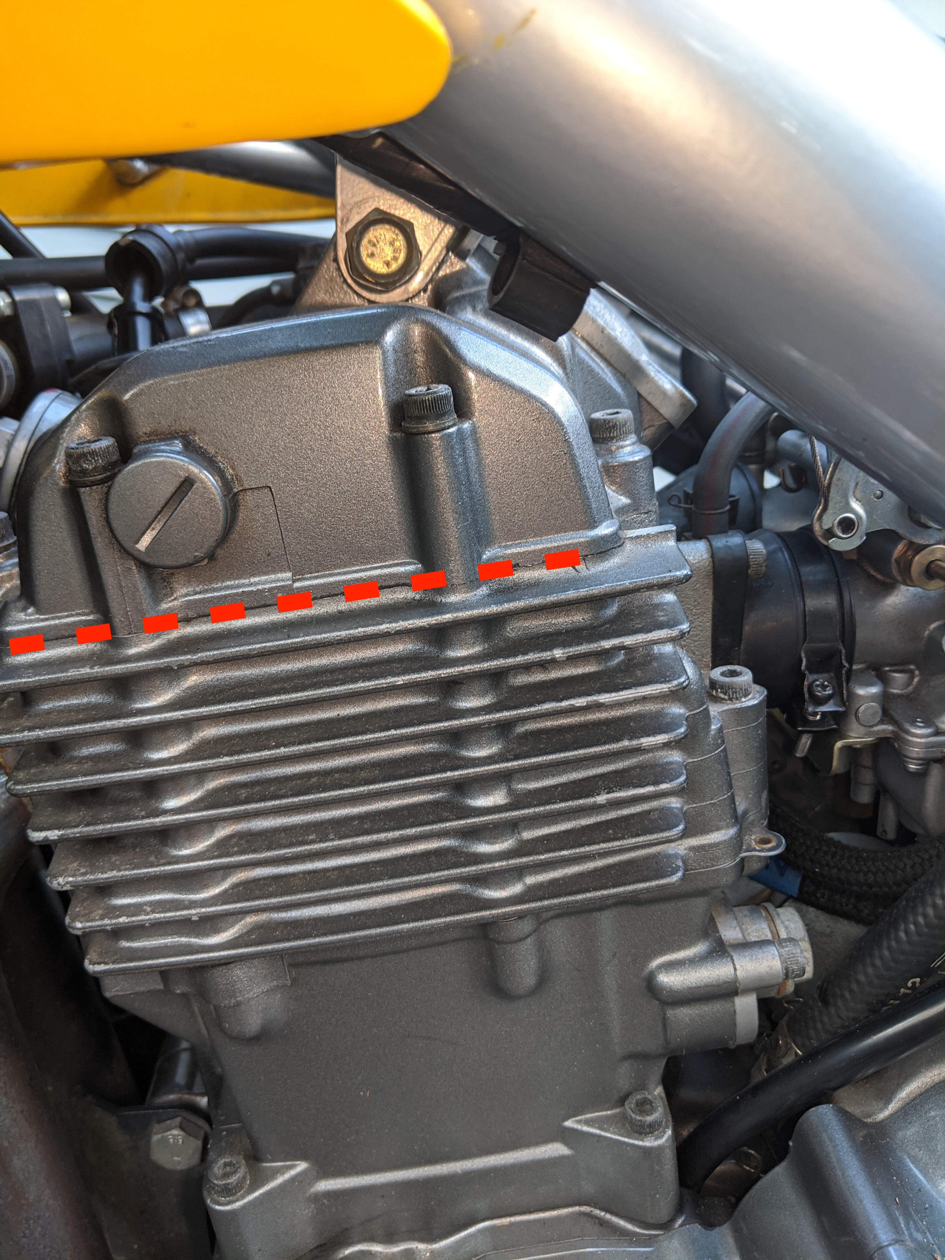

Actually, I feel that trying to "move" the nut from one unknown position to another is a bad idea. So my guess is that, if I can't fish it out with hopefully a smaller magnetic tool, I would have to open the engine to retrieve it. That would be an unexpected lesson on Engine 101 and a big job. Help number (3) --> Given where it is dropped, do you think I should be able to locate it if I only remove the top part of the engine (along dotted line)?

Wai, sorry to hear that. I suppose it's the nut from the LH adjustment screw. Next time: don't take the nut off completely, just loosen it & then adjust the screw, then tighten the nut & re-check (& re-do if required).
Now: do not turn the engine.
Probably the nut went out of view, to somewhere below the camshaft, but still in the top end. The thing to avoid is that it goes to the bottom part of the engine.
If you really can't find it, indeed you'll have to take the valve cover off.
If it's any conciliation, I once wanted to adjust the valve clearance on my Simca 1100 (it's a while back), and when removing the air filter, I dropped a nut into the carb - and that went straight into one of the cylinders. I had to take the head off... And there it was neatly on top of one of the pistons.
This is not something that can happen in your case, but the thing to be avoided is that it goes into the bottom engine.

How about a piece of Blu-tack or Plasticine on the end of a screwdriver?

I would suggest using a magnet on a stick thing to fish around for it. I have had good luck with that in the past.

I would probably make a magnet on a stick. Lots of cheap but powerful magnets available - one the end of a piece of strong but bendy wire so you can shape it as needed. What a remarkable PITA - but we've all done similar.
