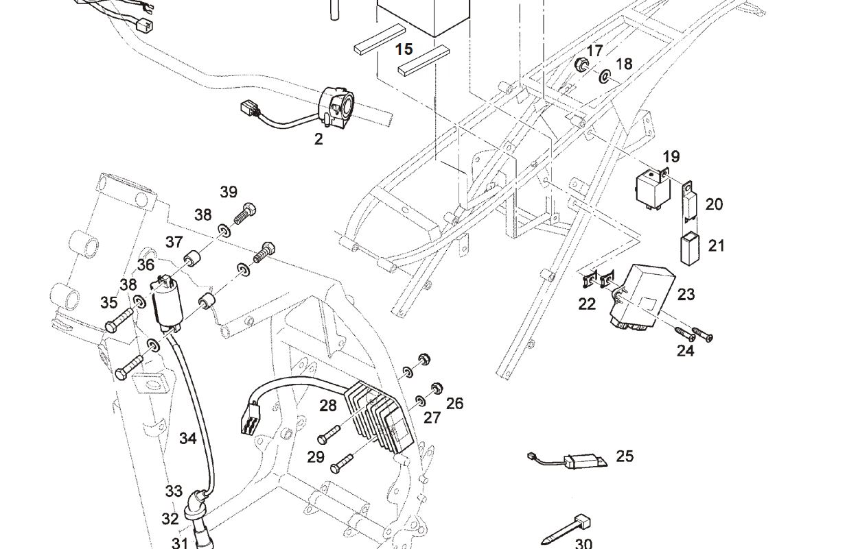

anyone know where the ignition module is on a baghira or mastiff, same bike ?
i cant think where it can be i thought it was the module above the sidestand but thats the voltage regulator....

Postby Guesi » Wed Aug 05, 2020 11:57 pm
It is number 23
