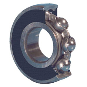

I ordered new steering head bearings from Grahams and was surprised to receive 2 x KOYO 62052RSC3 which are rubber sealed bearings which I'm more familiar with for wheel bearings. I checked and I'd got the right ones and they were the same as the ones I removed from the Mastiff. However, although they seem to work fine, they are not tight in the head stock and they will come out without any struggle whatsoever and I still have a little bit of clunking from the front end picked up in the MOT. I'm going to try adding spacers to the assembly to snug things up a bit. If that doesn't work, I've got 2 x KOYO 30205 taper roller bearings waiting in the wings which are the same inner and outer diameters (25mm x 52mm) but are 1.25mm deeper. If they don't work, I'll try the YZ bearings which another user has mentioned as being possibles.

Right, I see. What I said above applies to conical or thrust bearings, as are common in other bikes (like indeed the YZ). If this thing has normal ball bearings:
that would surprise me, particularly for the lower one which carries the front end. But then they should be fixated tight I'd guess.
Slightly bent forks... Are you sure there is no play between the outside of the bearing and the steering head? If so, try to resolve with laton copper (?? shim copper ??), or glue it in (JB weld, epoxy).

As I said, they were normal deep groove ball bearings which came out of the head stock and, with just 8,000 miles on the clock, I don't think they would have been changed unless a previous wheelie mad owner knackered them! They looked original when I removed them and were the same as the Koyo ones I received from Grahams.
With the help of Google translate, I've also been on the German forums and the "Order number: 9017620000 Deep groove ball bearing 6205.2RS" is confirmed, from the forum...."I had bearings sealed on one side. The lower one had started to rust from the inside out, despite plenty of grease filling. I have now installed bearings sealed on both sides (6205 2RS). However, I had not ordered them as original spare parts. They come from my dealer from the large excavation box for standard parts."

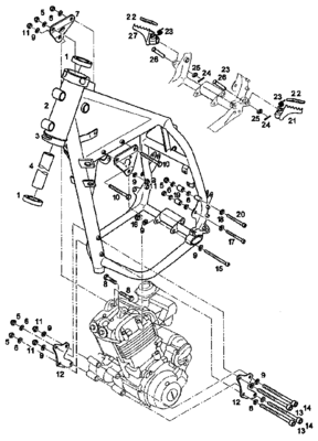

In http://www.miraculis.de/aw/download/mz/muz660e.zip you'll find
and that bearing 1 is a standard DIN 625-6205-RSR ball bearing. In the steering head, this bike has a construction like you normally find in a rear wheel hub, with a distance pipe (4, part no. 3621008000 it says) between the inner races.
Thank you for highlighting this construction to me, but I'd say conical roller bearings (like in the YZ) would be more suitable for the loads experienced in a steering head.
