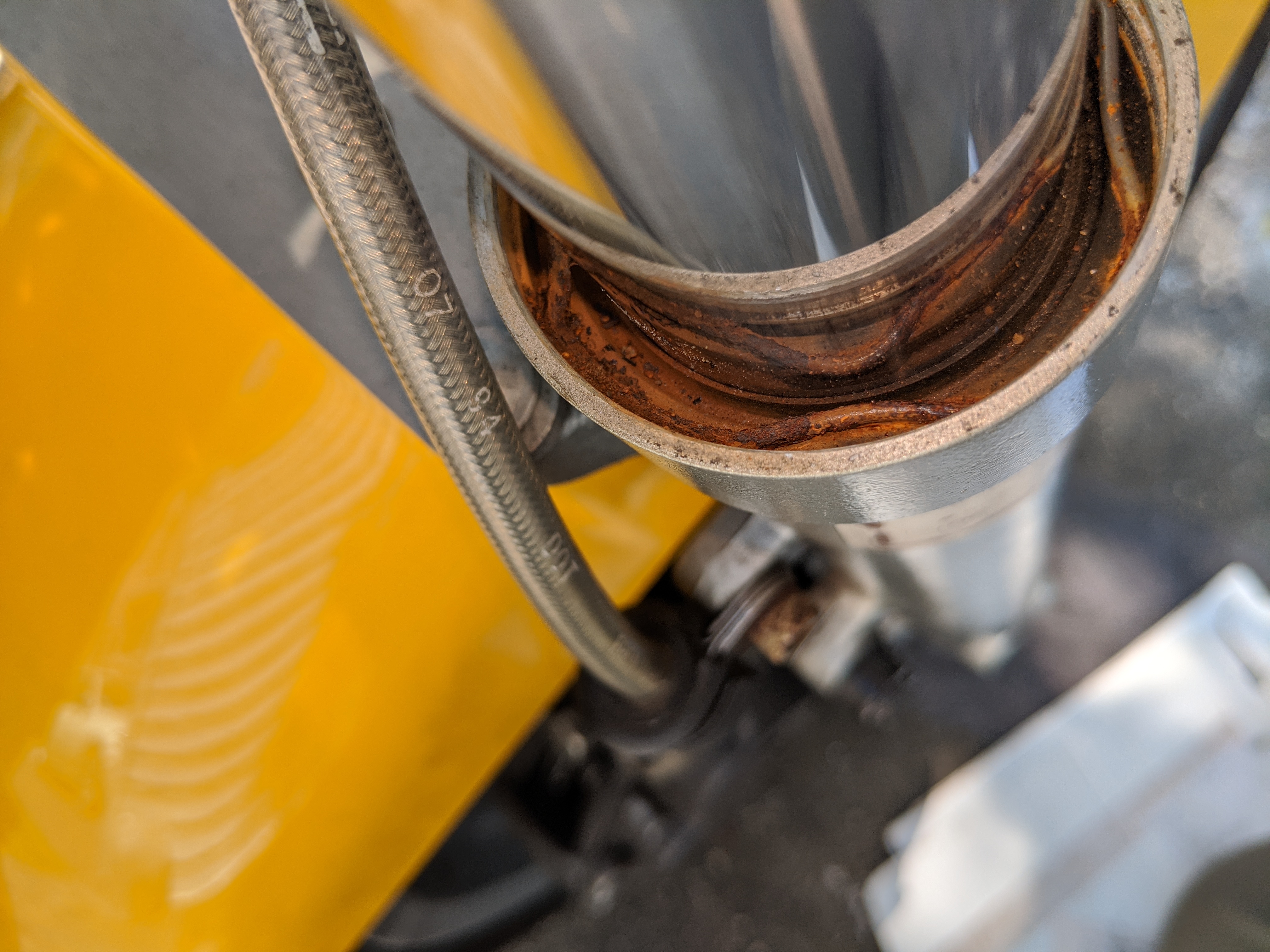

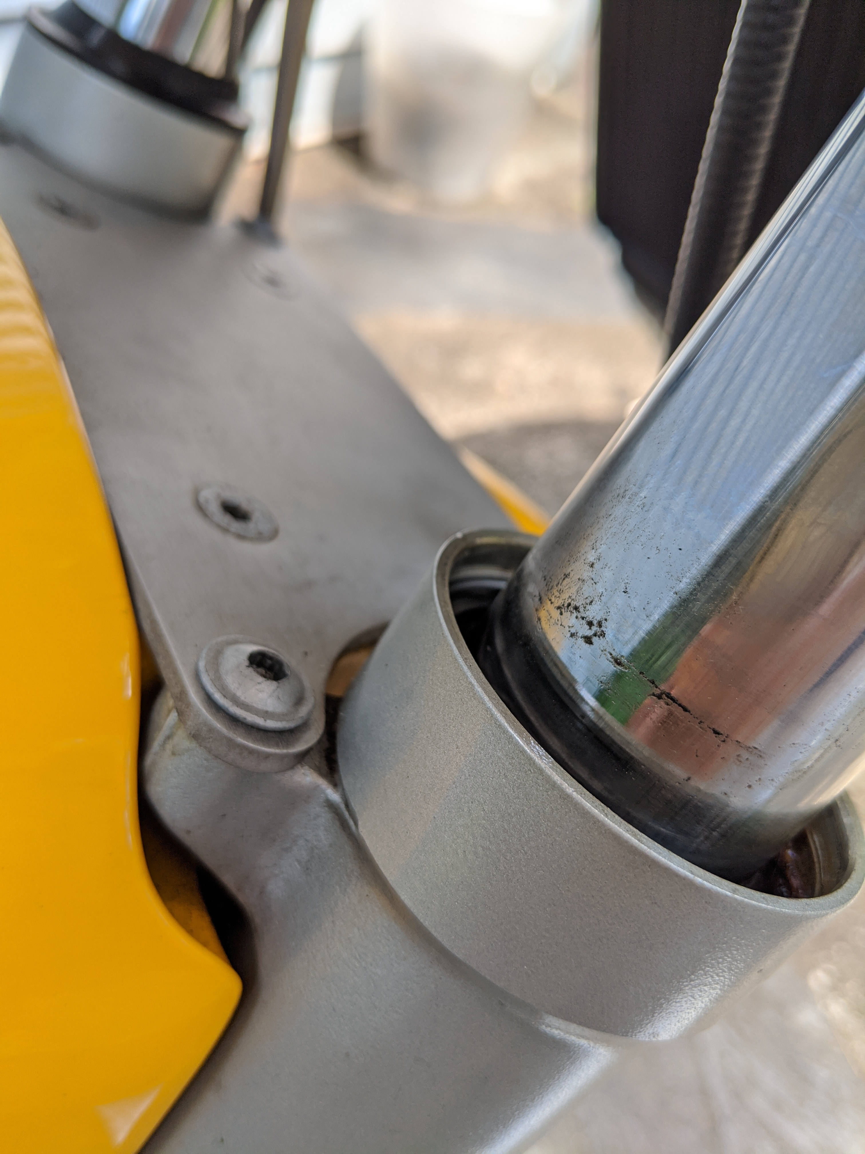

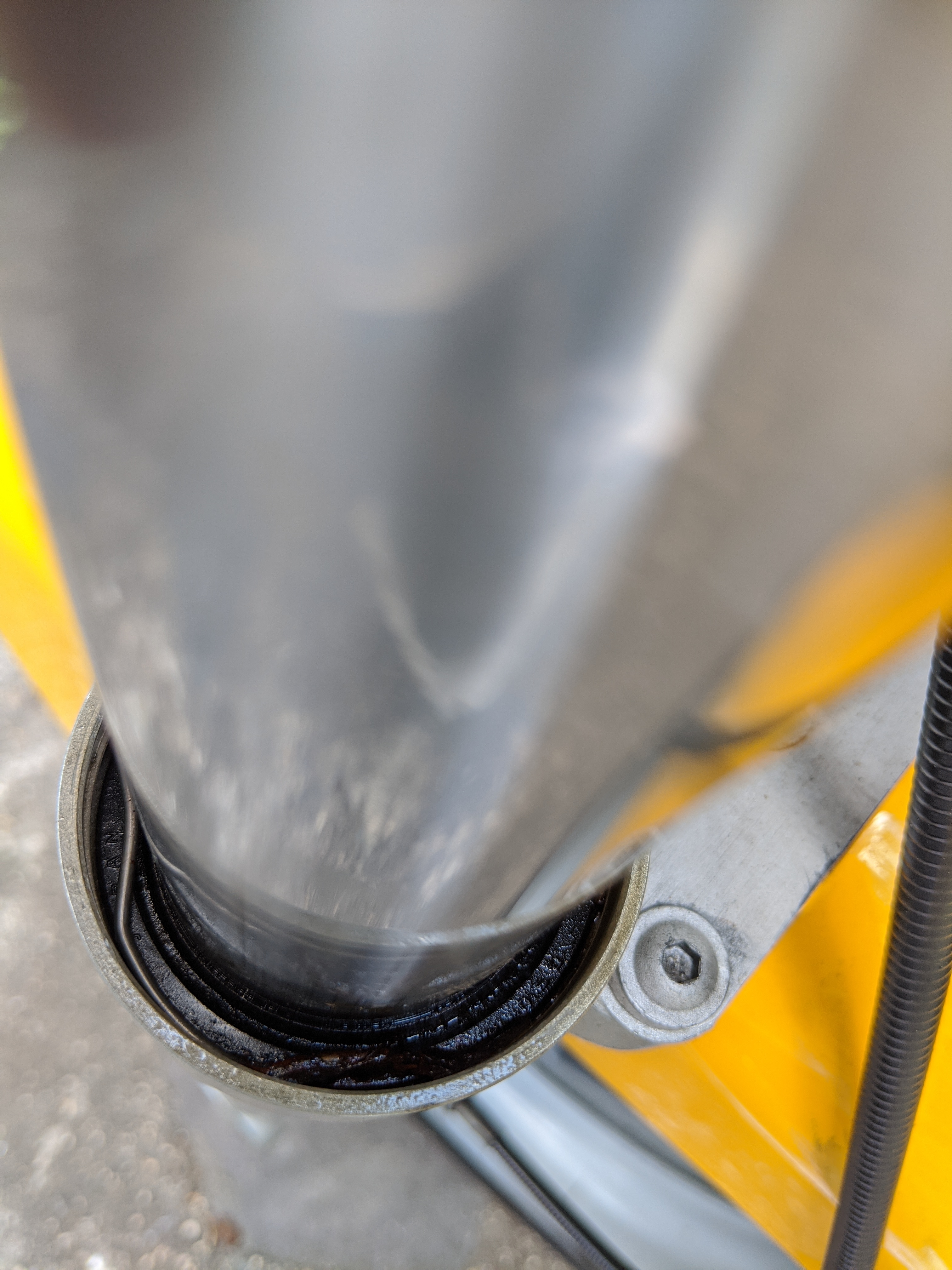

Just an update: I "lifted" the dust covers of the two tubes. The right tube has rust inside. While the left is alright, there are oil marks on the tube itself:
Right tube:
Right fork tube, rust inside dust cover
Left tube:
Oil residue on left fork tube surface
Left fork tube
Looks like the stopping springs also need to be replaced :(

Postby Puffs » Sun Jun 28, 2020 6:44 am
Thanks for the update.
I cannot see very well, but pitted corrosion on the stanchions will wear the seals down, and that may cause leaks. Absent of that, just clean & new seals + oil.
A bit of rust on that seal retaining spring need not be an issue, if it is still strong enough you might re-use it. But it does indicate it had some humid years...
