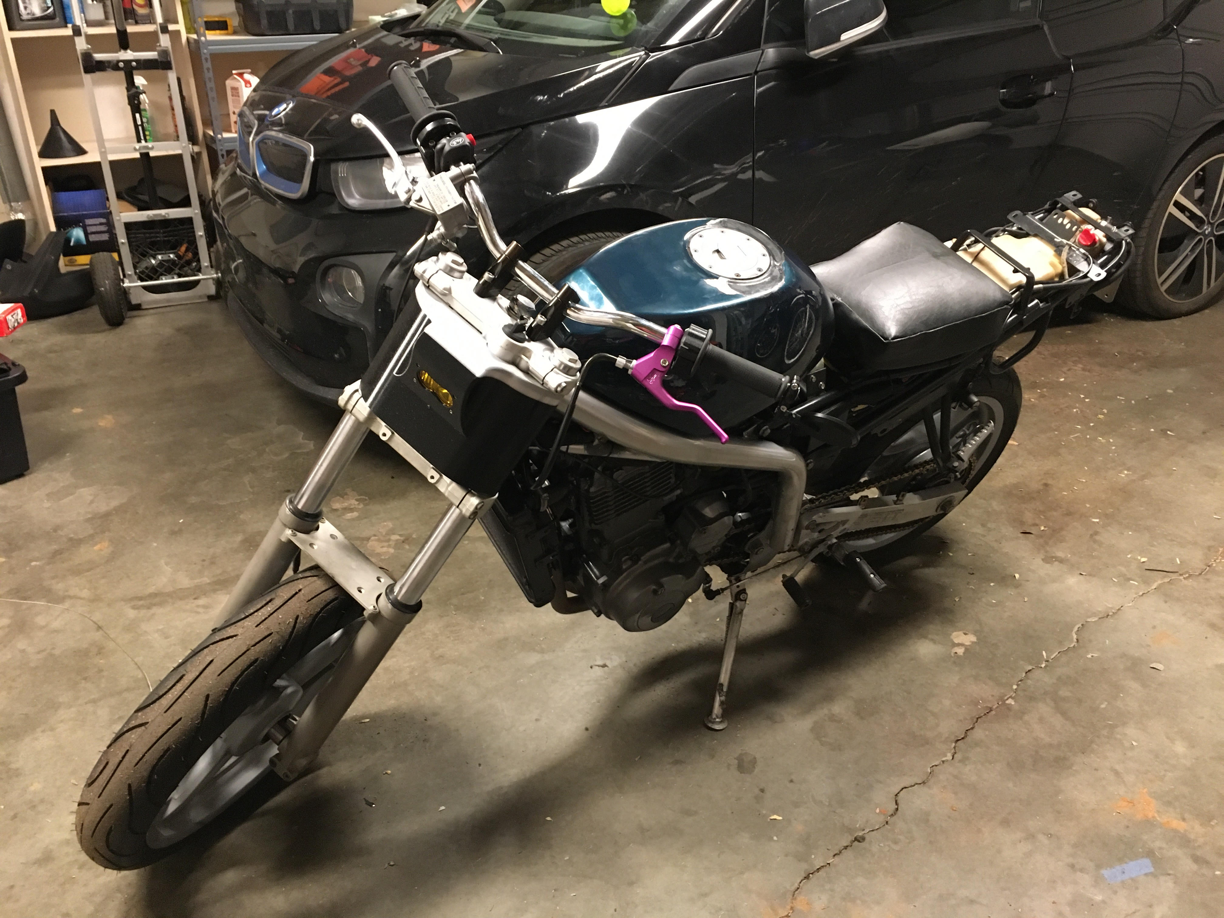

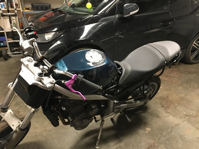

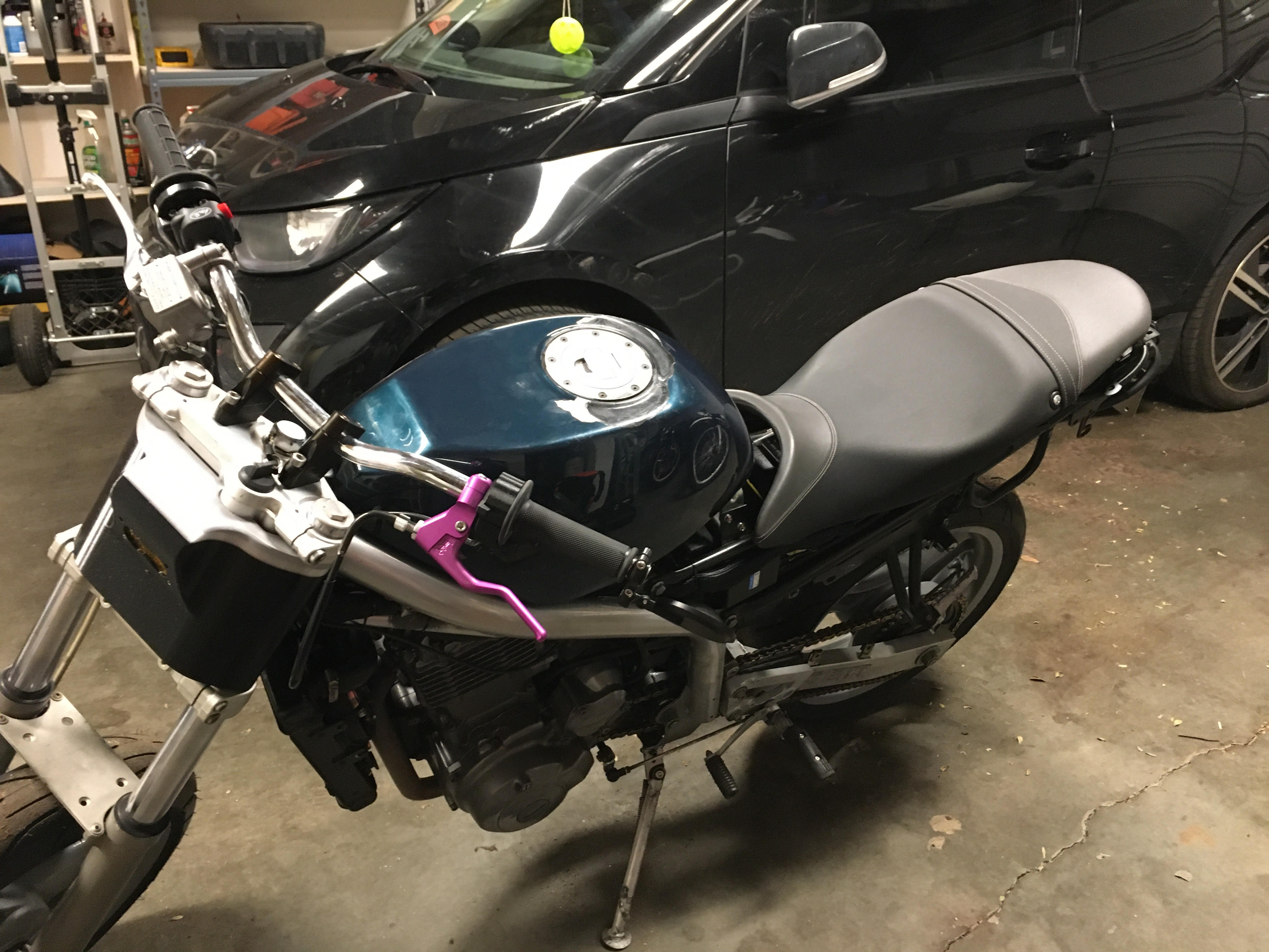

Here are some pictures. As you can tell, it looks REAL ratty right now. My goal was to just get it back on the road ASAP so I can enjoy it while I work out how to make it look as good as it rides, haha

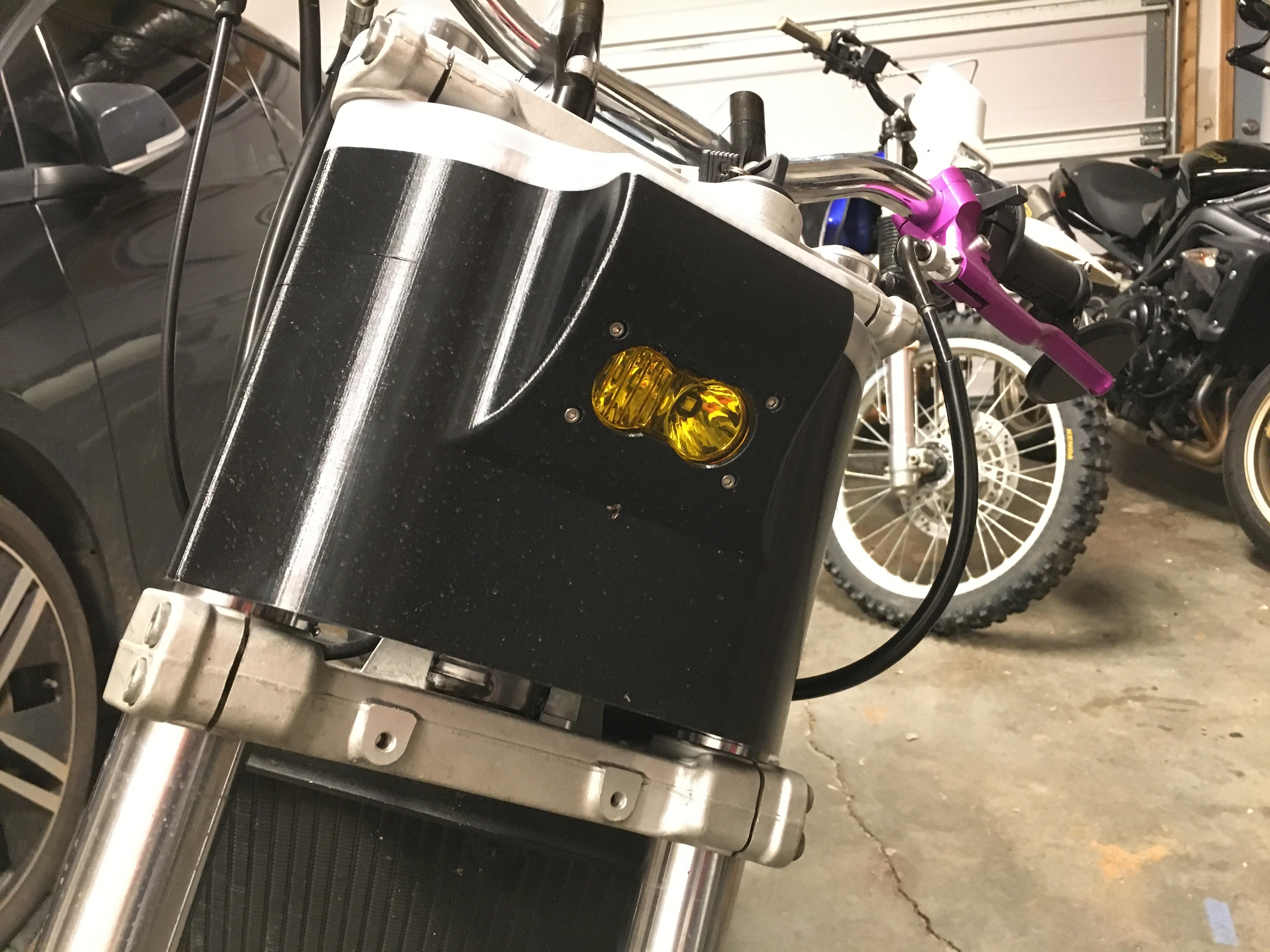

The headlight assembly while printing ran out of black filament and so I used some scraps I had just to finish it and test fit it. I have another all black one printing right now (just under 2 days print time though). I've got the angle of the light worked out and its super low profile and lightweight (only 8 oz)

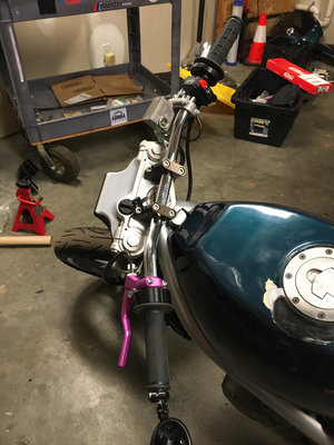

The handlebars came on the bike, I have some on the way that have a larger pull back to make the seating position a bit more comfy. Thankfully the bike had already been handlebar converted, though the handlebar risers are brown for some reason.... I cleaned up the bars by using a motion pro kill/start switch, a motion pro slim throttle housing, and a 3d printed choke housing. I am borrowing the RSC clutch lever from a friend to see if it works in the low effort setting (it does!). It won't be purple forever, I promise. The key is a Sicas racing lightweight item with a 3d printed part to make it go into the OEM hole.

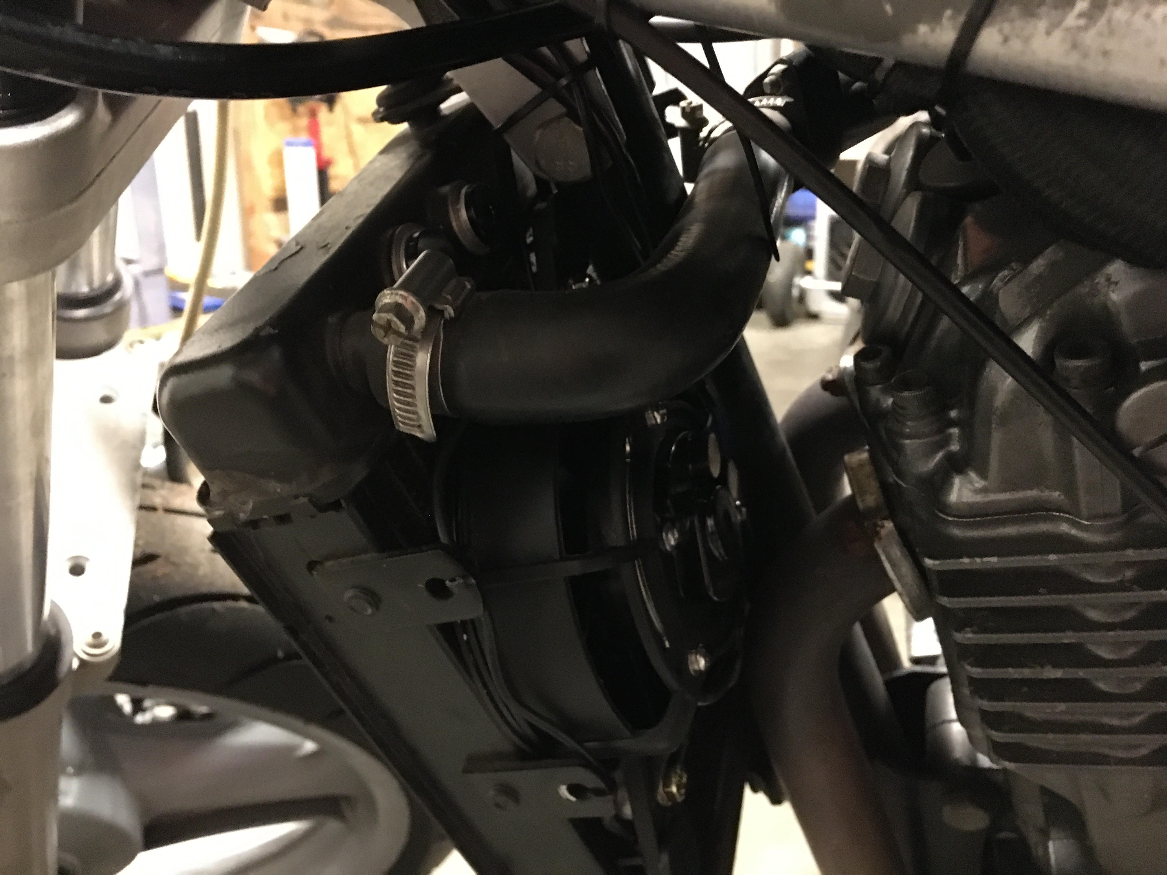

The radiator lost both of the fans and coolant temp sensors (as the fans didn't work, they were unplugged when I took apart the wiring harness. Plus the plugs were quite heavy). The two holes in the radiator got aluminum plugs and a tusk fan unit was installed. At some point I will probably do a 3d printed bracket for the fan to get rid of the metal parts, but for now it works.
The stock seat is pretty awful, so I added some foam and recovered it, but as you can tell from a previous picture, upholstery is not my gift. The bike is ridable again and much more comfortable, but I want a better looking solution. I just sat the street triple seat on the bike to take a look and it matches fairly well. In reality I think I'd love to just go with the stock skorpion long seat that exists on the tour, not the sport, but I can't find one of those anywhere. I am VERY open to suggestions on this; it is for sure the part of the build I am least happy with at the moment.

PostPosted: Sat Apr 18, 2020 5:15 am
by Puffs

Radiator fans: are you sure you wan to have those off?

I may have not been clear: I took off the disconnected (not by me, some previous owner had disconnected them from the wiring harness) stock fans and replaced it with an aftermarket temp variable fan with controller. Lighter than stock and more peace of mind. It seems this bike runs VERY cool too.
